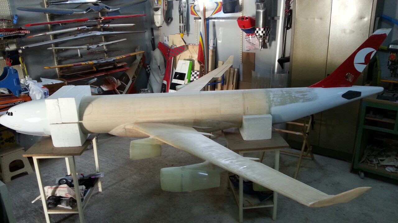

I'm plannig to carry out a wing loading test to my 1:16 scale A340-200 before maiden. Positive "g" will be 3g and negative "g" will be 1.5g. The weight of the fuselage (including fuel) is 15kg and the wing (including engines) is 9 kg.
So, what shall be the test load on the wings? 15kg times "g" or 24kg times "g" ?

Wing weight isn't a part of the load on the wing's spar in flight. The wings in flight actually have a negative weight- they weigh less than zero as far as the spar is concerned. All of the stress on a spar comes from fuselage weight. That's even true on a flying wing design as the center of the wing carrying fuel, engine, batteries, etc. is the only load the wings see.
That said, 3 G is not much of a safety margin for a model. Sure, a gently flown scale plane might not ever see more than that, but aerobatics planes routinely see 10 G or more. I think if it were mine (just as opinion here) I'd start with 5 times the fuselage weight and hold the wings at the middle when testing. That doesn't perfectly replicate flight loads, but it would tell you if the design is sound. Others with more knowledge and experience than me may weigh in with better suggestions.

thanks for your answer. I'll consider your 5g suggestion. Attached is a photo of my bird. Still needs a lot of work....

The wing center needs to support only
the weight of the fuselage. Test the wing
center with the weight of the fuselage times
the number of G's.
Support the wing on a saddle where the
fuselage would mount and spread weights
over the wing in the fashion that the air would
push while lifting the plane.
Each side of the wing can be tested for its
ability to support the weight of the engines.
Support the wing by its engine mount and
spread weights over that side in the same manner.
Use weights totaling the engine weight times the
number of G's. This will test the ability of the
wing, nacelle and engine mount to carry the
weight of the engine, though it doesn't factor
in the engine's thrust.
