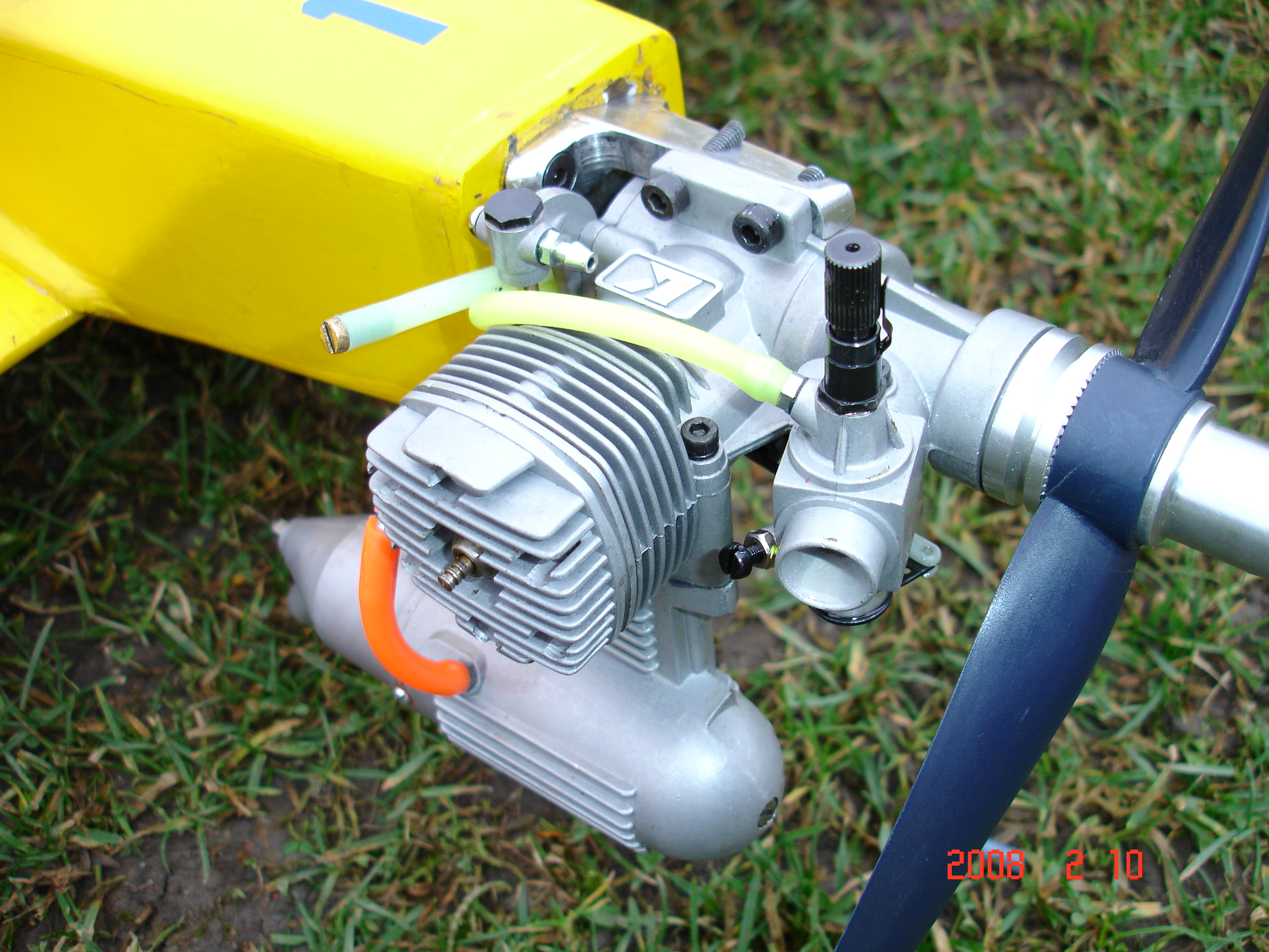

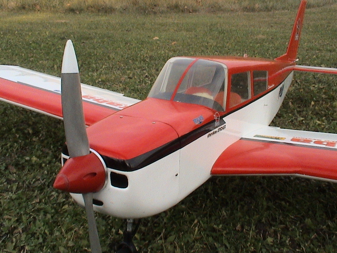

If you fly at sea level an 11x6 prop is the best size for most sportplanes with a .45 engine, but...prop brand is equally important!
Best props on the market performance vise is Graupner G-Sonic, APC, and RAM!

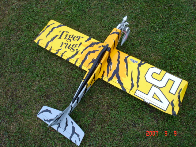

You can ofcourse use a any prop, including a 10x6 on a .45 engine. On a Q-500 type of plane with a span of 130cm a 10x6 is better but on a 140cm span Cheeroke a 11x6 is the prefered size.
