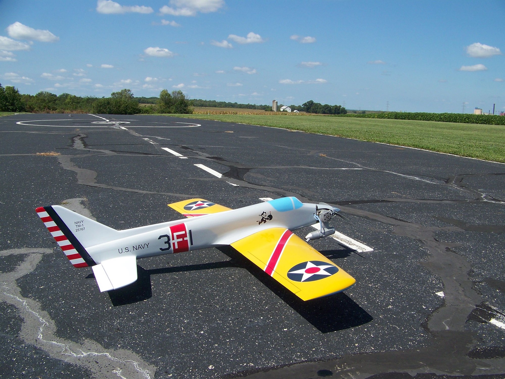

Some colors, specifically Cub Yellow, tends to be transparent. What I have on the bench will have a yellow top wing, and grey for the rest, A liberty Sport, so I was planning on painting it a single base color first, but not sure yet if it should be Silver, so thought I would ask first before buying it. Going to use Randolph for the grey, Sig for the yellow and other colors since I would only need a small amount, and the smallest Randolph is a quart.
So should I use Silver as the base for everything and apply my color coats over that? I was thinking to prevent bleed to apply a couple clear coats over the silver.

I used silver, really aluminum, dope and then yellow on a Bob Dively SU-2 many years ago. This worked very well. Aluminum is totally opaque so it hides all the color variations in your wood and fillers. Now I use Klass Kote and have been putting down a coat of white before red and yellow. These typically have very low hiding power. The Troublemaker in the photo was done that way.

I would use KK, but the smell is ten times worse than dope. It also must be sprayed for a good finish, and spraying in winter time usually doesn't work out very well. I found Rand-O-fill, so going to use that as the base coat. Thanks.

Good looking aircraft. I only have a couple of "nits" to pick, just to make the markings more accurate:
1) The color scheme needs a red ring around the nose, this goes along with the red stripe and chevron to show it's the lead aircraft of section one, as indicated by the "1" on the side of the plane
2) The rudder markings, when using the vertical blue "hinge" stripe, needed to all be vertical. The red stripe was at the rudder trailing edge with the white stripe in the middle. When using the horizontal red and white stripes, there was no blue and the stripes were limited to 13 total, of equal width and with the top and bottom stripes being red
The above said, I wouldn't worry about changing anything if you're happy with it

The deviations in the color scheme were intensional. The fin markings are not accurate either: TM-1 for Tony Bonnetti Troublemaker rather than a Martin Torpedo bomber and a serial number that looks a whole lot like my AMA number! And I came way short on the number of wings the plane with those markings had. Well shoot, it ain't sittin' on the Saratoga either!

I like the Randolph dope. The fuse is ready for the prime color now, the silver rand-o-fill came out really nice. Still have the wings left to base, but have one more coat of Nitrate to do on one side first. Need to take a break though, the fumes got to me last night and I couldn't sleep. I need to build a new extractor system using the lasers extraction fan and 6" hose. Having the exhaust fan overhead isn't pulling the fumes out.

I went with Rand-O-Fill for the base and it works great. The polar grey will cover in one coat from my test. I will have the wings base coated tomorrow and Sunday can try the yellow and see. I found that if I lift the lid on my laser and crank up the blower and do the doping in front of it then no fumes are smelled anywhere in the house, and I checked airflow, I open the door to the garage and there is a breeze that flows down and into the room. I just need to set up a work bench in front of it now for applying the dope and I'm good. Everything has been Nitrate coated and sealed, sanded and ready for color. I still need to order some 4 ounce bottles of blue and black and replenish my Stix It pint, nearly empty.
I have done white before on a Cub and it too was transparent and took several coats before fully covering, where the Rand-O-Fill covered completely in 2 coats. It blended very well too, no brush marks, can't say the same for the white. My yellow Cub has no brush marks, but has about 8 coats of yellow! If the top wing covers in two coats, then I know the trick, if not, well, keep trying.
