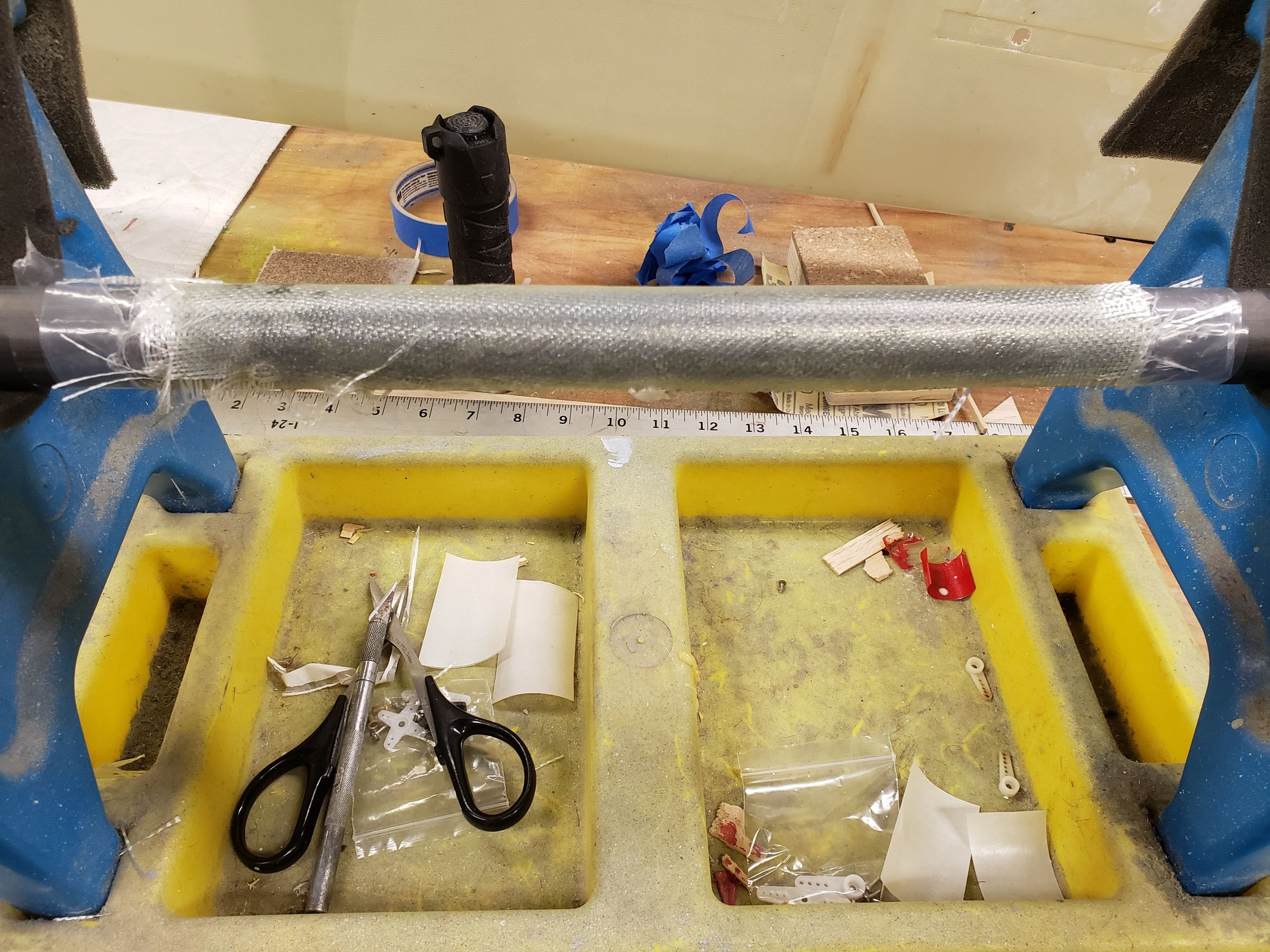

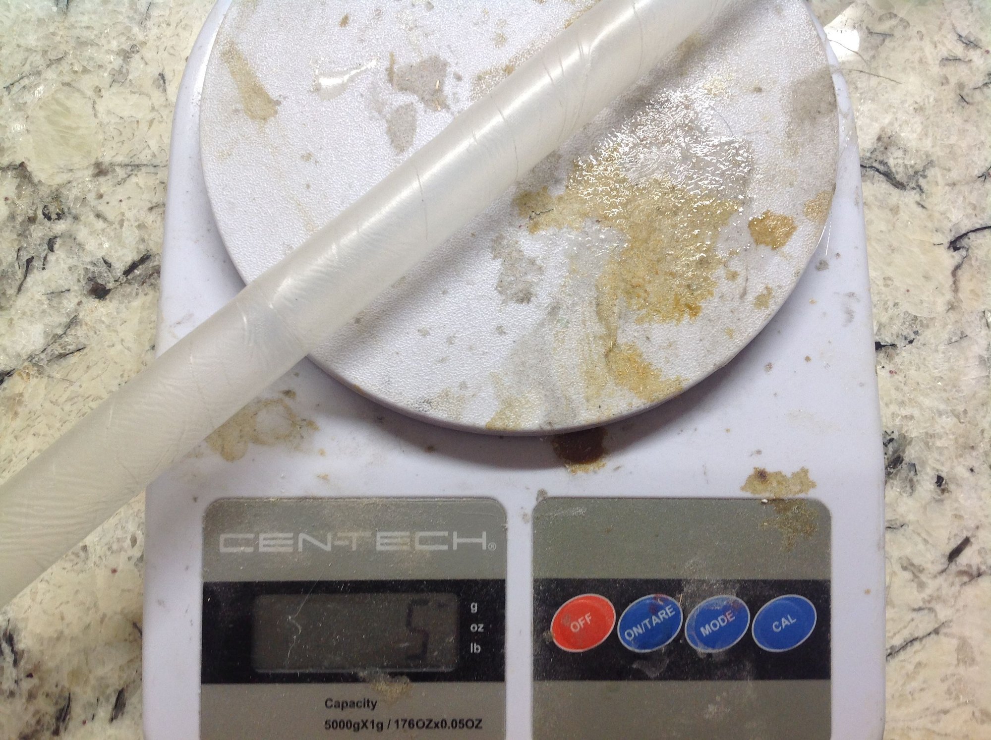

The best and easiest solution is Braided Biaxial Sleeve. There are a lot of choices in fiberglass, and several in carbon.
I wrap my mandrel with nylon vacuum bagging material and then slide the sleeve over it, pull it tight, and apply resin.
Thats a great idea where weight is somewhat flexible. My current project has me counting every gram.
