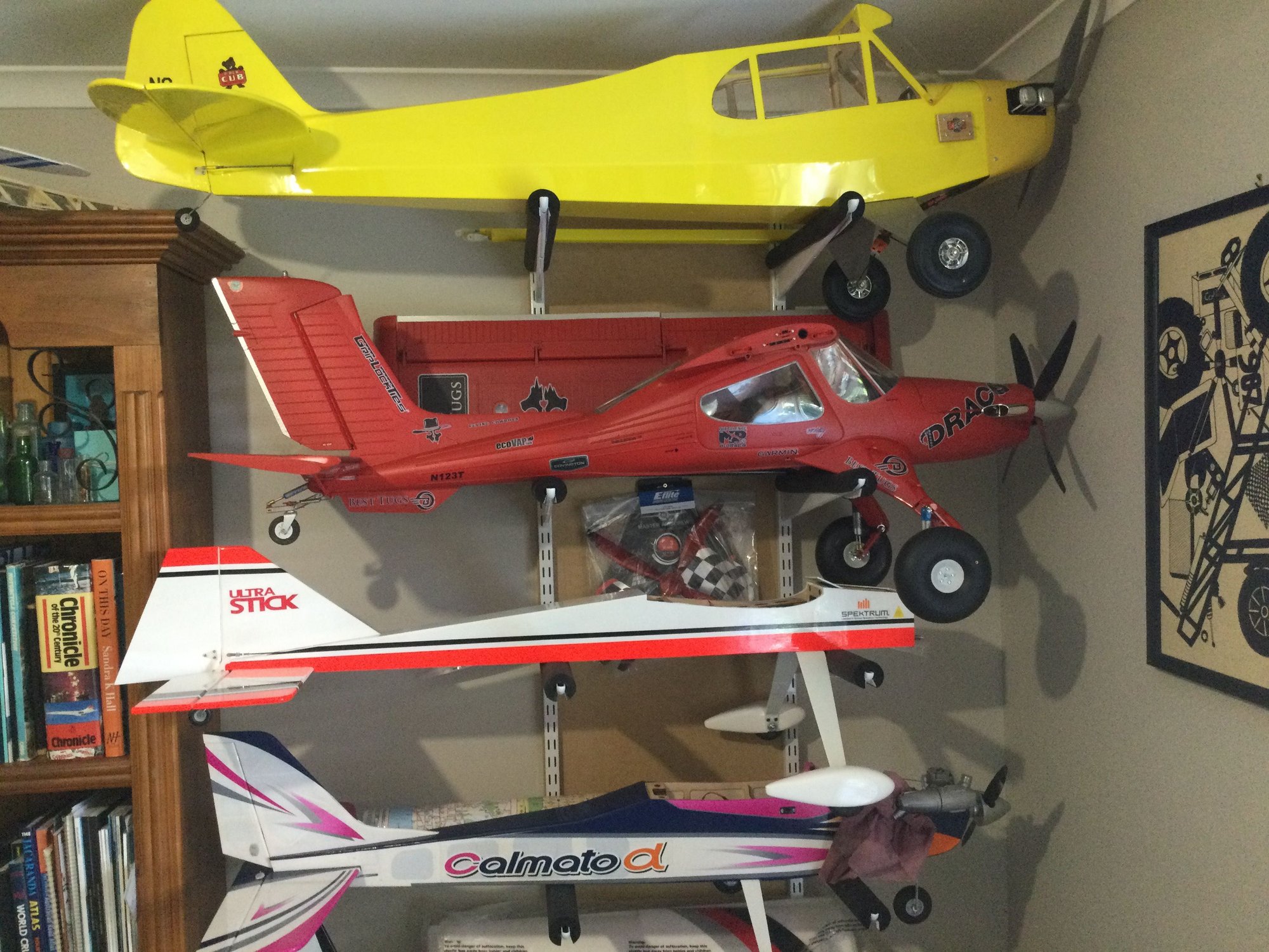

I have a cub that weighs around 10lb ( 4.45 kg ) approx.
It has a 50/60 electric motor at present, it’s not fast but flys ok.
I would like to repower with a fuel engine, gas, glow, two or four stroke.
Any idea what options and sizes would suit this plane ?

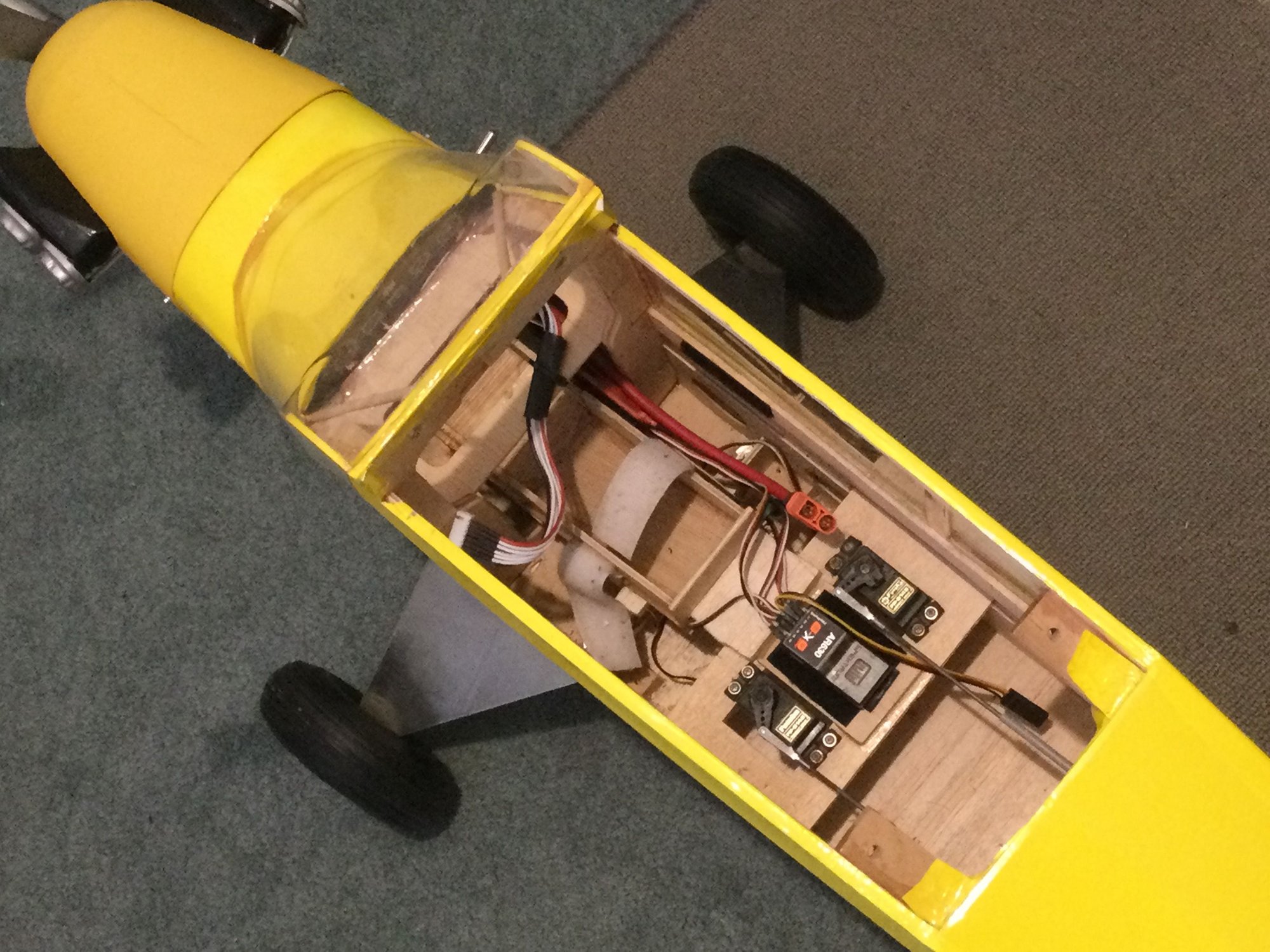

Forget the w.s. and engine size,
he has to modify the firewall,
replace the engine mount, secure that,
take that battery out and put in a fuel tank with modifications to allow for it.
Then he has to find a spot for the throttle servo, the linkage, and add more tail weight to find the new CG, which he doesn't know where that is either I bet.

2.350 mm. ( 8 feet )
The model was bought from a elderly guy at auction, that had scratch built it.
It had a 50/60 motor, 100 amp esc, 6 S battery etc.
I fitted a Spektrum receiver , fixed a few issues and it flew well.
It weighs around 10 lb without the 6 S battery.
The engine Mount box will need to be rebuilt I imagine, no big deal.
I have a OS max 0.95 that I was thinking of fitting .
The purpose of the question was to get some ideas.

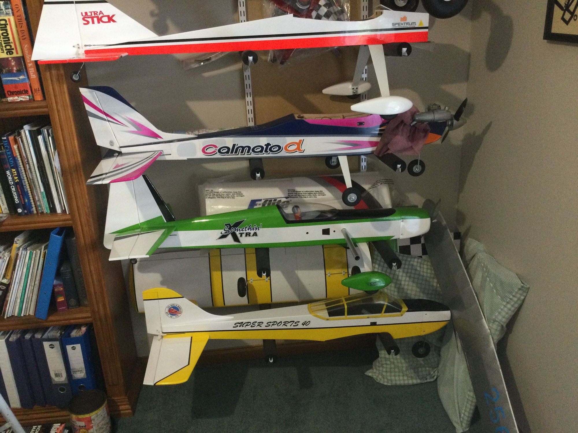

You mentioned Something Extra, Ultra Stick, I have them as well.
Thanks for the input , I’ll move forward and see where I end up, cheers.
Ohh, forgot to mention, I did only pay 75 dollars for it !
