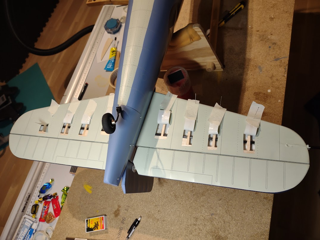

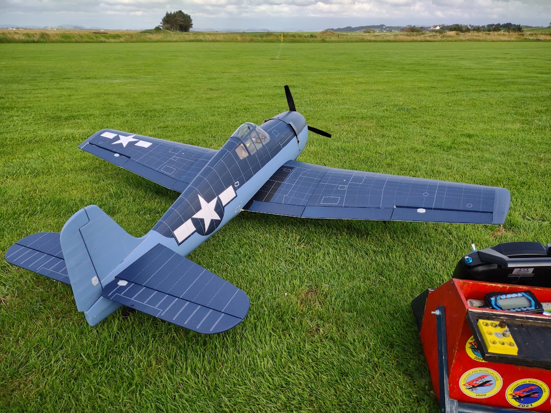

I have for a while battled with a VQ F6F Hellcat. Nice looking model, but has not impressed me much for the time I have had this. Powered by a Saito FA82B. The main issue now, is that the horizontal stab flutters a lot during straight flight at speed. Hinge gap i tight with CA hinges. I have even tried to stiffen up the stab by installing a Ø5mm carbon tube through its whole length, but without any luck. Seems to me that its basic construction is just to weak. Large stab, conventional built up by 8mm balsa stringers. Any suggestions how to deal with this?
Any advice greatly appreciated
Good looking .40 size ARF model, but it stops there....
Stab stiffened up by installing a carbon tube through its whole lenght:

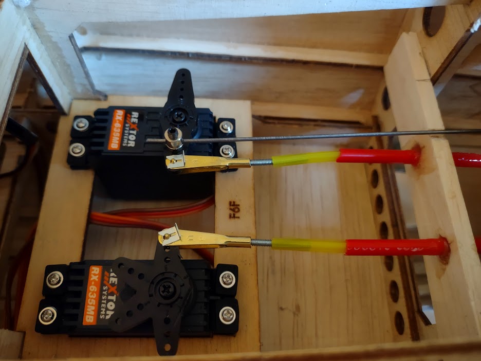

As the first one is easiest to chase first, I will try to take this one first. There was some play in the elevator which I traced down to the servo. Standard Futaba servos was mounted (new) but had some play in the bush/bearing. Replaced these with some more costly servos with ball bearings and metal gears. This instantly helped a lot. There is still a minor play in the linkage. Seems to be from the flex in the pushrod. Red type of Sullivan gold-n-rods have been used, and it seems that there is some clearance between the tubes inner diameter and the pushrod itself! Would the blue ones fit tighter in its sleeve? The rest is tight and good. I think I will do a testflight sooner or later and see if the servo swap help. Some pictures from the linkage:

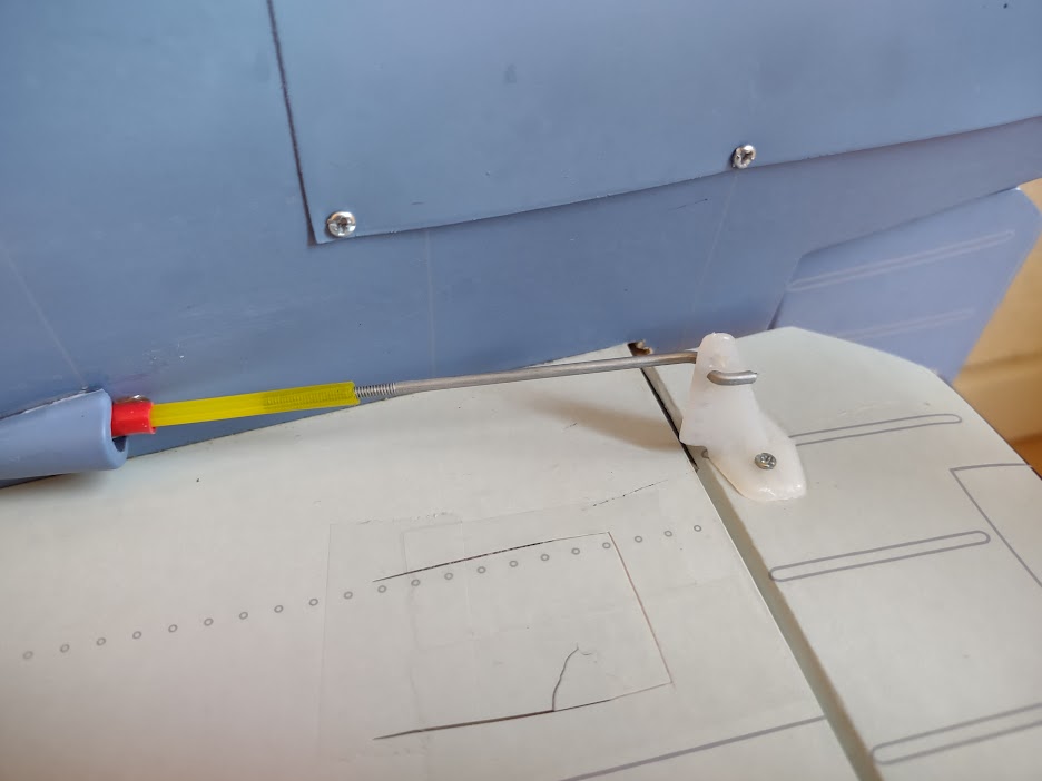

Given that swapping out pushrod can be a real pita, this may be info for the next plane. The red Sullivan rods are usually labeled as "flexible". The general intention is that they are useful when you have to snake a rod around other structures or go around a curve. I generally use them for throttle linkages and small airplanes up to about .25 engine size. The blue "standard" rods are much stiffer. The stiffness comes more from the sleeve then the inner rod. I would have to go out to the shop and check but I'm pretty sure that the inner rod from a blue sleeve wont fit in a red sleeve.
You are correct about this. From my memory, the inner rod from the blue will not fit inside the red sleeve. The red version was used due to availability.
It was much easier to get good hardware back in the -90`s then it is today, especially here in Norway. ARF`s has basically killed the market for hardware....
What I can do, is to replace the inner rod with a 2mm steel pushrod and slide pieces of Sullivan inner rod onto it, evenly spaced along its length. This configuration is commonly used on most Great Planes models I have had, and seems to be pretty stiff and slop free.

When I look at the photos I see some things that I know is not good.
1. you are using red Sullivan flex rods and they flex! They are only good for small slow flying 0,8cc-3,5cc powered airplanes.
Instead use either pull-pull, thin steel fishing lines or carbon fiber tubing.
2. You do not have contra nuts on the treads on linkages! This makes more play in the clevis due to play in the treads.
3. A rule of thumb is to always use as short servo arm as possible and as large elevator arm as possible.This is to avoid excessive play in the servo gear.
In your photos I can see that the elevator linkage is mounted way to much out on the servo arm and that the elevator arm is way to short.
