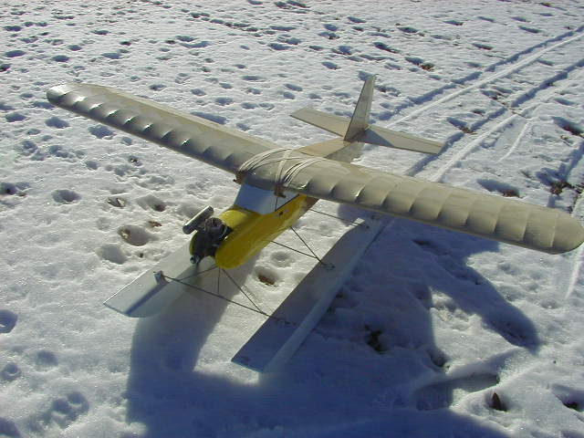

You may find the ski and float page on my site usefull. I fly using floats instead of skis myself due to snow conditions. ( foot prints, wind blown ridges, etc ) The floats skip right over all but the very worst conditions.
Skies work well for some folks that have frozen lakes, open unused areas, basically smooth solid snow.
Skies take proper setup to maintain good flight but weigh less than the rigid float option.
Randy
