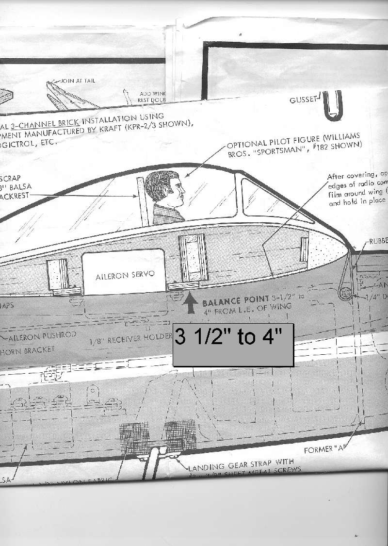

i recentley got a falcon 56 trough some trading. does anyone know the cg point on this plane?
it seems to be balanced now about a third of the way back on the wing.

It has an airfoiled tail. I don't remember the exact CG - I built mine in the 70's, but about 30-33% will work fine.

If memory serves me right, the CG is right on the wing spar. (that's with an empty tank)

As stated, right on the spar.

On the CG... "on the spar" may not help much since the original and MarkII versions had a single central main spar -- you can't really tell right where the spar is once there's opaque covering on the wing. (I don't guess there's much need now that it's flown and checked out OK... but 1/3 chord should be a fine location for the Falcon's CG.)

According to the plans the balance is 3 1/2" to 4" from the front of the wing this puts it to the back side of the spar plus 1/2"

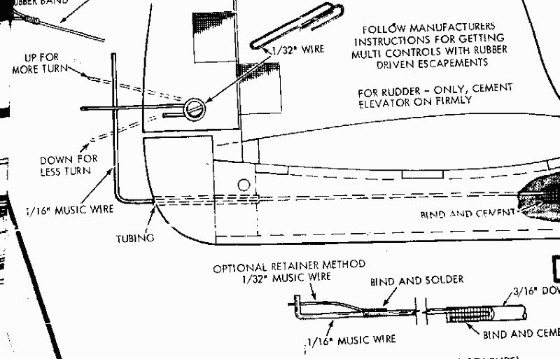

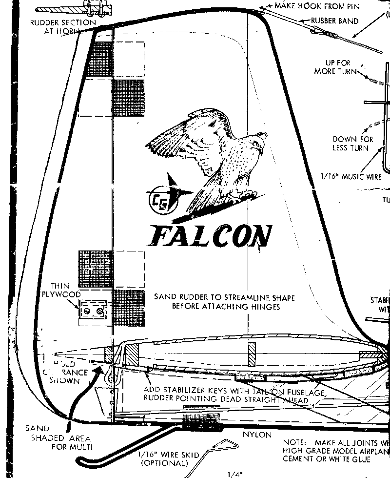

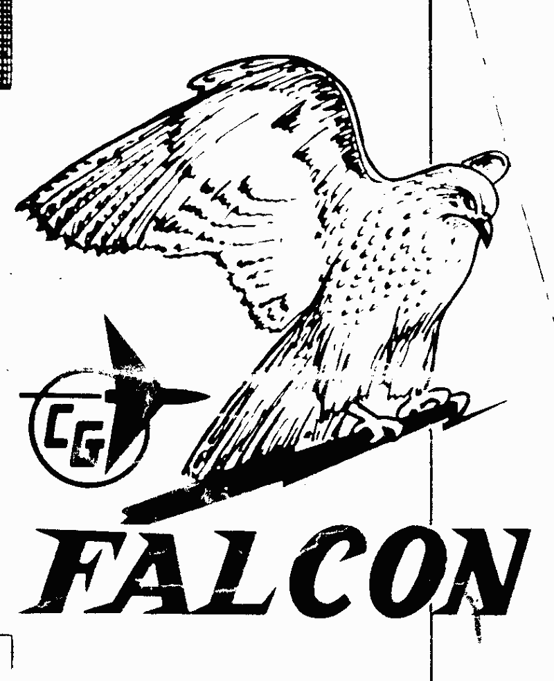

A clarification (or maybe an oops?)... the versions of the Falcon56 may have gotten in my mind scrambled up... I'm not so sure anymore when spearate upper and lower spars came into use on the Falcon 56. I had said it was on the MarkII, but it may have been later.
Dr. Dave -- which version are your plans for? I see they still have the single central main wing spar.
For nostalgia buffs... here's a scan of the birdie for the tail feathers. I can't remember any longer whether he's supposed to be white or yellow, but here he is to transfer to the covering color of your choice if you need him to complete a covering job like the prototype... a shot of the tail to get the original shape, and finally how to do the linkages if you're using escapements. Check the nylon fabric hinges, too... much more convenient than those ol' thread hinges!

Al the plans are for the mark II and it shows a two spar wing the front one is sandwiched between two basswood strips and the rear one is balsa, it is also the rear servo mount. I still have the decals if anyone is interested.
