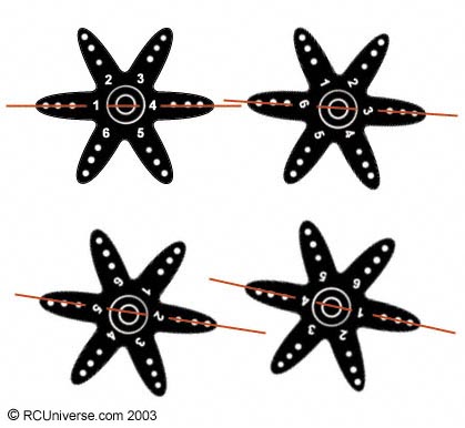

Does anyone know if there's a way to adjust the centering of a servo? I'm using Hitec HS-425BBs in a Kaos, and when I attach the servo arm to the servo, it's off one way or the other when the servo's in a neutral position. Since I have a single aileron servo, this biases the ailerons one way or the other. Thanks for any suggestions.

By rotating a 6 point servo wheel, you can adjust that. Notice that each arm is numbered. Rotate to the next number and it will be off slightly from the previous one:

That only works on Futaba as they have an odd number of splines. You can rotate an arn 180 degrees and it will offset by 1/2 spline because it is odd.
Hitec has an even number of splines so this does not work. This is my only complaint about Hitec servos.
Ov course with a computer radio, this is not a problem as you can adjust the center in the radio (without affecting the trim control.).

JR spines are odd-numbered also, so you can get 1/2 spline adjustments. But in re-reading the original question, a slight angle off dead center will not have much influence on your set-up, and you then adjust the klevis at the control horn end to center the aileron.
