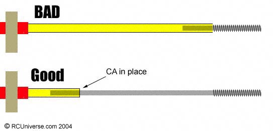

The laser Rods will work fine, just be sure to have metal ends that go from the Fuse Exit to the control horn.

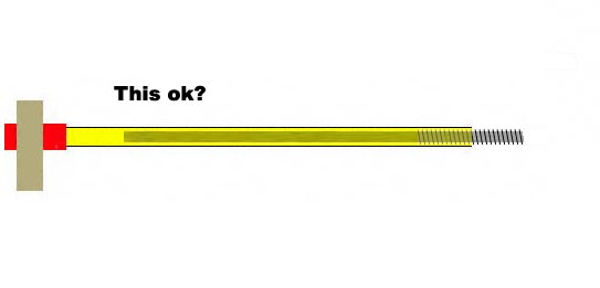

Old 01-23-2004 | 05:04 PM
Joined: Sep 2003
Posts: 17
From: galesburg, IL
Default RE: Flexible pushrods?
MinnFlyer,
I was taught to install the threaded rod in this manner, does it look okay to you?
