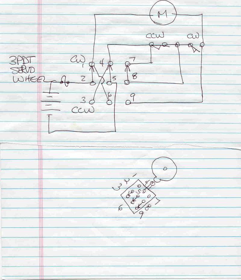

Anybody out there familiar with or know of a link to make an electric jackscrew? I am wanting to make one out of a low voltage screwdriver (3.6 - 6.0 volt). I am not an electronics expert, so I need details on how to set up, and wire using microswitches, etc.

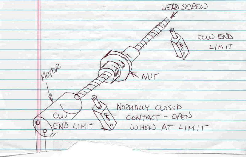

Well it looks like you can read it! Yes! The CW and CCW limit switch are wired normally closed before the stop. Then at the stop the switch opens.

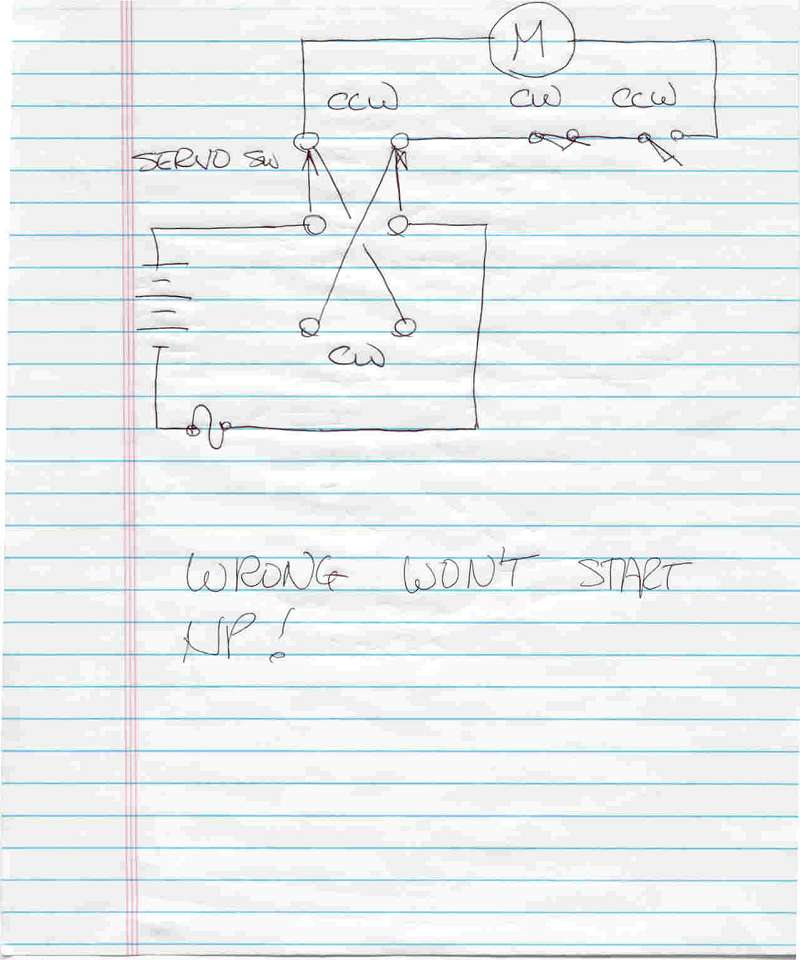

Default RE: Electric Jackscrew
This will teach me to post while I'm eating! The circuit won't work! As it is traveling both switches will be out and short the battery. Give me a half hour.!

I should know better than to think anything is simple. I do this for a living!
You need one 3PDT lever arm microswitch and 2 SPDT lever arm microswitches.
This will work. Fuse the battery!
John
Note the direction the switches operate. If the motor turns backward it wont shut off!
Reverse the leads to the motor.
Flypaper,
If you use just a DPDT switch, with 2 NC end travel limits. When it reaches the end it won't be able to turn back on again! I've looked and 3PDT switches are available as toggles or you can gang using bolts 3 SPDT switches from Radio Shack #275-017 for $2.69 each SPDT Switch with 3/4" Roller Lever
