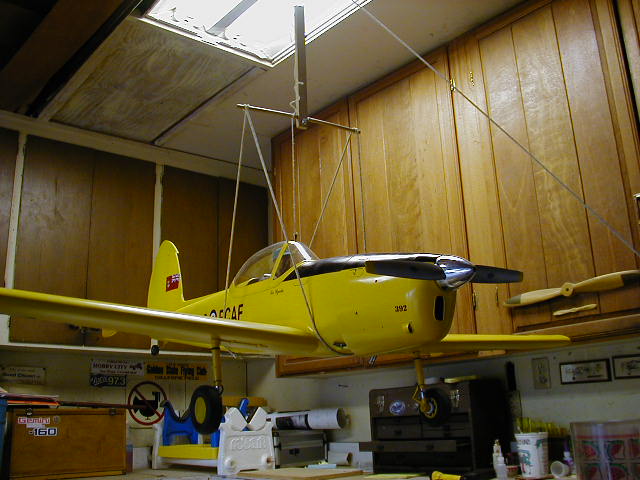

A sling works great for balancing a biplane. See the thread at http://www.rcuniverse.com/forum/m_17...tm.htm#1715012

This is from Lennon on Bipes, and has always worked for me. The balancer is called a Vanessa. A plumb bob is suspended from the same point as the aircraft, and points directly at the balance point. A monoplane is shown, but the same works for the biplanes that I have built.
Les
I don't know why it is taking two tries to get photos on, but we will try again.
