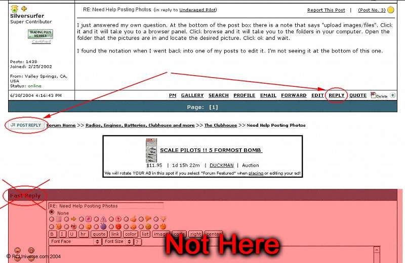

Old 07-23-2004 | 10:26 AM
MinnFlyer's Avatar
Posts: 28,519
Received 9 Likes on 9 Posts
From: Willmar, MN
Default RE: Covering help please
Jaka, to post pictures, don't reply in the box below, click the "Post reply" button. That will give you the option od uploading pictures.
