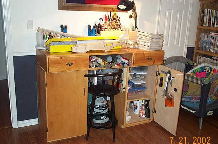

Go to a surplus building supplies warehouse or find a remodeling contractor and get a couple of cheap base cabinets (like kitchen cabinets). Ususally $30-50 will get you a couple (atleast in my area). Place your door on top and there you go. If you don't want them to move, tack one piece of 1/4" plywood to the backs of both cabinets.
I had a specific size and purpose for mine, so I built the three pieces. Cost about $125 for supplies and hardware, 4 hrs of work.
