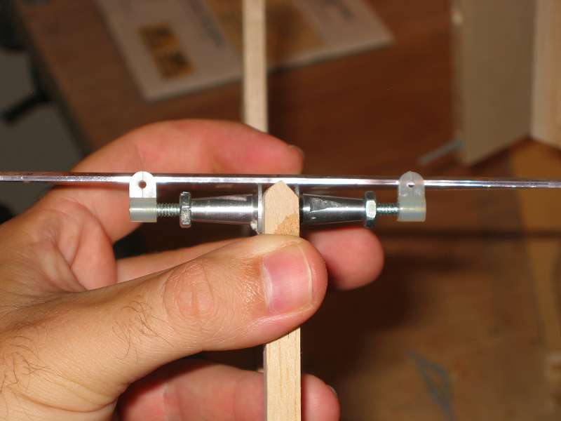

Second picture shows the actual with supplied white plastic horn
Third picture shows that the holes in the horns are inline with the hinge line looks a little off in picture but it is inline,

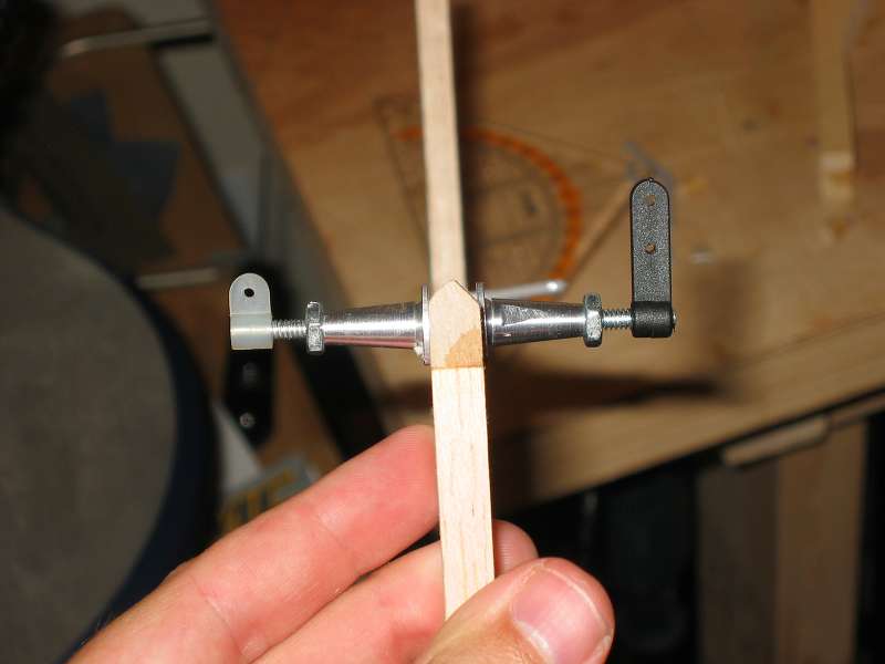

The fourth picture is what Dubro should supply with this set. The black torque rod coupler is from Dubro Heavy duty horn set.
I expected this to be a problem before drilling the holes and looked arround for those balck horns but no one sells them, and decided to try make it work.
But no way it will work the supplied base plate diameter is the same as the white horn to screw distance You can't have the bevel and have this working without cutting the aliminum base plate.
Now I paid $10 for this set and it does not work, I can't buy the black long aileron torque rod couplers alone and I have to buy the Dubro # 867 fpr $6 to get the black couplers and redrill hole at a backward place insert dowel and drill again.
This is simply a design flaw. What do you think, am I missing something?
If I want to have the horn holes in line with the hinge line you have to drill it close to the LE but then the base plate is the problem.

Hmmph, you're right, the plastic arm is too short. What were they thinking? Since you have a flat control surface, maybe you could just do without the base plates. I can't tell from your pictures (nice, by the way) but if you have a dowel/hardpoint there, you probably can do without it.
I have the same hardware included for the extreme flight yak I am building. The rudder is airfoiled and the baseplate will be tilted a little so there will be less material overhanging the hinge line. Still, I will have to move the horn back a little so that the plate fits. The hole in the plastic arm will be behind the hinge line, which I believe is OK as long as it's just a few mm's.

I have the dowel, I tried removing the base plate but then the problem is as the control horn is so close to the LE of the rudder it limits the throw that I want from the rudder, I could gain more throw from the plastic horns. So the best thing for me is still to move the horn back.

Based on my research you actually want the holes in the horns to be slightly behind the hinge line. See http://members.cox.net/bdfelice/Ackerman/ackerman.htm for more info. If you move the horn back 1/16 or 3/32nd of an inch that should help keep the base from interfering with the vertical stabilizer. If after moving the horn back the base still interferes then you could file a little bit of it away.

One simple solution is to simply ignore the problem and let the holes in the horns some distance behind the hinge line. Measure the distance and then make the holes in the servo disc the same distance behind the servo disc mounting screw. This will take care of your problem but it presumes that you have access to some kind of servo disc instead of straight servo arms.

The only other thing I could suggest would be to not use the aluminum cones as well as the plates, just use the threaded rod. Kind of a waste though... You can take a pair of 6-32 blind nuts, grind off the barbs, then thread them down the rod and epoxy them to the rudder surface to brace/stregnthen it. Perhaps this would give you the clearance you need for decent rudder travel and you wouldnt have to re-do things. Where do you fly, you are around the corner from reading.

You could just grind the base plates to clear the hinge.
You could move the hole back a little.

Well Dubro replied to my email and they offered to ship black couplers, now I am happy and A+ customer service, they stand behind the product they sell.
My problem is a small item and maybe detail for a company, if they change the shipped white ones with the balck ones in future productions then this is good for them and us.
