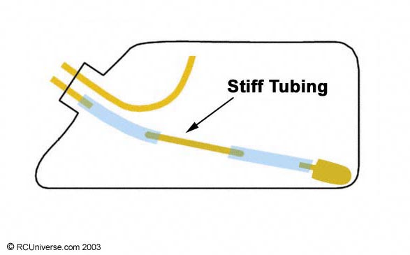

Ok the way i was taught was. that the clunk stayed at the back of the tank. and moved up and down if the plane was upside down or right side up. ok one of the guys at the club say. that it has to move to the front too to get fuel in the engine in a dive. im like no capilary action will leave the fuel in the back of a tank in a dive. the helie guys have the clunk going to the front but when ur in a hover i dont think there any gees on the tank forcing the fuel to one side. ohh well. what do u guys think? thanks.

The guy in your club is an idiot... but that's obvoius, he's from New Jersey
(It's ok, I'm an ex-Jersey boy myself)
But seriously, you do NOT want your clunk to go forward in the tank. In fact, I usually place a piece of stiff tubing in the clunk line to PREVENT that from happening should you come to an abrupt stop.

yea, you want the klunk to stay in the back

In addition to the previous, do not have the clunk up against the back of the tank. It needs to be 1/4 to 3/8 away from the back of the tank.
Either that guy doesn't fly airplanes or he has a lot of deadsticks. As mentioned, you want the clunk to remain at the rear of the tank.

No, I'm afraid not.
Assuming that the aircraft is in a vertical dive with the engine at idle it will speed up (accelerate) until the force of gravity equals the drag force. From that time on the aircraft will fall towards earth with constant velocity, i.e. with zero acceleration. When this happens fuel will accumulate at the front part of the tank due to the force of gravity. Remember that the fuel itself is in a sealed compartment and not subject to air resistance.
As an analogy consider yourself in an elevator going downward at constant speed. Pour some water out of a bottle and observe where it will end up. Presumably on the floor. This is true for any speed of the elevator as long as it is constant.
Interestingly enough the fuel will accumulate in the front of the tank even during the first phase of the vertical dive, when the speed is increasing. This is because air drag causes the acceleration of the aircraft to be LESS than the earths gravity, i.e. 1g (32 ft. / second squared).
The fuel in the tank however is free to move about at will relative to the surrounding aircraft and since it is not subject to drag forces from the air it will fall towards earth with an acceleration equal to 1g. The front of the tank will of course stop the fuel from falling out of the plane :-) and hence this is where it will end up.
The only way to get the fuel to collect in the rear of the tank during a vertical dive is if the thrust of the engine is maintained so that it is greater than the drag forces acting on the aircraft.
Since the stiffness of the fuel tubing prevents the clunk from falling forward towards the front of the tank, the reason the engine doesn't die during the dive is that it survives on the fuel available in the fuel tubing between the clunk and carburettor.
IMHO, the main reason that the engine doesn't stop during the dive is that the dive isn't maintained long enough for the fuel in the fuel tubing to be used up.
/Red B.

There wouldn't be a "noticeable blurp" because a bubble of air in the line will simply cause the engine to go lean for a second, assuming that the fuel in the line is replenished soon enough. If not the engine would go lean, then quit.
Red's right though, the main reason the engine doesn't quit is because it's very difficult to maintain a dive long enough to use up all that fuel in the line. If the engine is throttled up in the dive then the fuel will remain at the back of the tank, if the engine is at idle, then the consumption is very low.
Keep the clunk at the back of the tank.

Red B is correct. The fuel does go to the front of the tank pretty quickly. If you are high enough, you can kill the engine this way. But as others have said, you generally are not totally nose down with throttle up high enough to drain the line. And it is surprising how quickly air in the line is sucked through.

IMO, the only "abrupt stop" with enough force to get your (unstiffened) clunk up front while flying is called a crash.
Guess that depends on your definition of a crash.
I've had my clunk wind up at the front of the tank after hitting the tall grass at the end of the runway when I landed too fast.
Dennis-
Old 08-13-2004 | 06:44 PM
Posts: 5,550
From: Hubbardston, MA
Default RE: Clunk Question
Oh, and I've been using that piece of stiff tubing for a number of years now and have never had a problem since.
