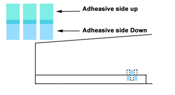

Why not just replace the CA hinge with a covering type hinge? Much easier, and no cutting.
In case you're not familiar with the procedure, cut 6 pieces of covering about 1/2" x 1 1/2". match them up as 3 pairs of 2. Now, working with 1 of the pairs, turn 1 upside down, overlap about 1/4 inch and heat them together. Do this with all 3 pairs. Next, weave one through the gap and attach it to the bottom of the wing and the top of the aileron. Slide the next one through the gap right next to the first, but reverse this one so that it will be attached to the TOP of the wing, and the BOTTOM of the aileron. Then, attach the third one the same as the first.

Ya know, Mike, I was thinking about something like that, but I wasn't sure how to implement it. I did put some clear "packing tape" on both sides of the broken hinge area, and although it sealed the gap it didn't provide any support to the aileron. I thought about the weave process, but the adhesive needs to change sides so I didn't go any further.
The other advantage to your suggestion is that if the color swaps on the two sides, its not a problem.
Thanks, I'll be doing that repair before the day's over!

Rodney, that is a good site and good explanation of the techniques. I did the repair to my TwinStar, and the spot seems as tight and strong as the other hinges.
