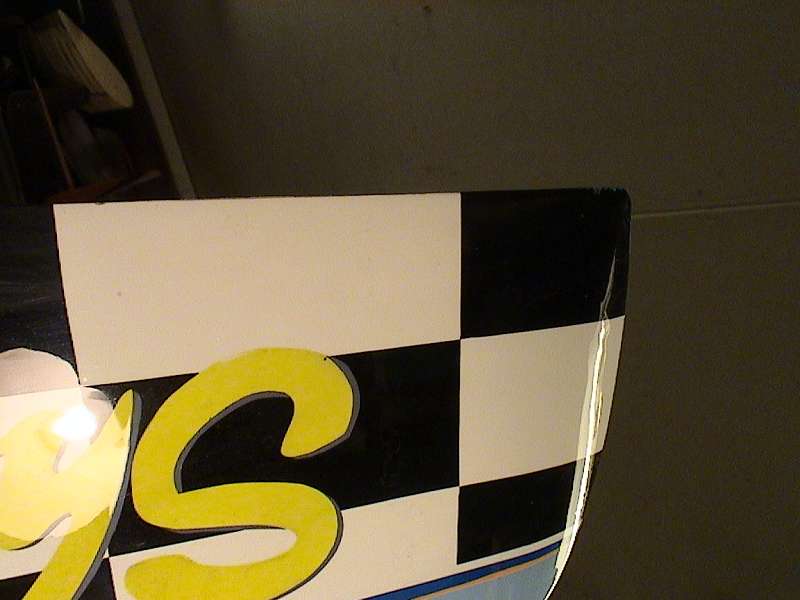

Watching this silliness, I have to conclude that those warning against trailing edge shapes have never taken the time to find out for themselves how little it affects our model airplanes, and are merely passing on urban legends.
ID:	211412   Click image for larger version
