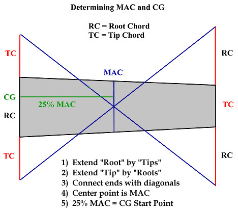

I am trying to find the cg of an aero sport 300L. I bought it at a swap meet and know nothing about it except what is on the plane itself. anyone got any ideas?

Here's a graphic that will help you get a good starting point.
If you don't want to take the time to do it, starting at 25% of the chord will be safe.
