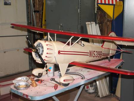

I covered my WACO with Cover Rite. I used LustrKot primer and paint with no problems.
I've used Cover Rite before and primed with spray can auto primer, also with no problems.
