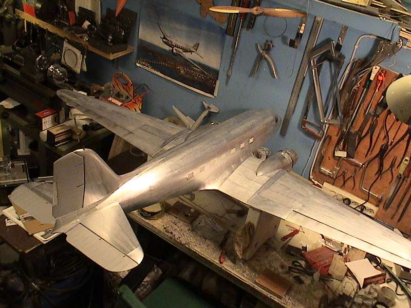

Hi!
Monokote will not work but Oracover will if the fiberglass fuselage is sanded first.
I have covered fiberglass surfaces with exellent results for years but as I said ...Oracover or Solartex or even better Oratex is the material to use.
Here is some pictures of my Marutaka covered my DC-3 covered in small pieces of chrome Oracover.
Regards!
Jan K
Sweden
Regards!
Jan K
Sweden
