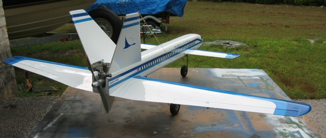

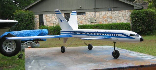

Pictured below is my Starliner Mk III. It has a 61" span, 44" length, weighs 6lbs and is powered by an O.S. .45fsr. It is a kick and a half to fly, very stable, yet responsive. My favorite manuver is to roll up to a 90 degree bank, give full up elevator and do a 360 degree turn in about 50-75 feet at about 90 mph. (no joke, it will do it!, haven't broke the wing yet!). Currently I have about 60+ flights on it.
Later!
