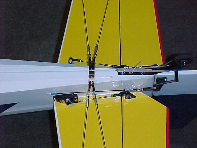

Here's how I did mine...with coated Kevlar, K&S aluminum tubing, and electricians crimpers. The alum tubing is just big enough to get the strand through 3 times. I loop it through the connector, then come back through it again, then come back again for the final time. If you practice, the way you rig will help when you have to get that final tension, just before crimping.
The final adjustment is where the eyelets come into play. If you installed correctly, it should only take about 3 or so turns of the eyelets. The kevlar does not stretch either.
Here's a pic of the top.....this has the clevis's....BTW...this is a MidWest 27% Extra...
and one more of the bottom area rigging.....
Also..the plyers used for crimping...I got at HarborFrieght for about $3, there's a few different types of crimps on them.
Here's pic..

Thanks guys, I see there are no knots so its either by way of shrink wrap and glue or crimping.

Hi Robert...that's a Midwest 300S. I got the kit for such a deal, I couldn't pass it up. The only diff is the flat stab, and that really didn't matter to me. Actually the elevators are different as well, to compliment the foiled tail on the newer ones they have counter-balancers. I was going to scratch out updated stabs from plans, but really didn't want to spend more time and money in it. I'm very hooked on it as it is.
Hey...what am I tellin you for....with a screen name like yours...I'll come to you with questions...(just kidding)
Really though, hehe....this is the only 27%er I have at this point. The next step in Giant's will be the GreatPlanes 330 @33%
