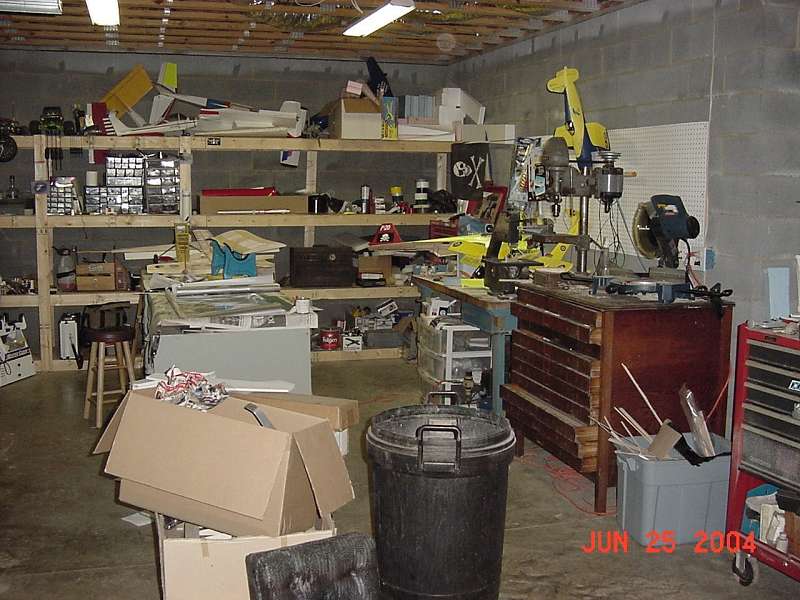

Have fun building a shop. I think I got enough stuff in this one to give Burt Rutan a good scare on the next X prize.

Goodnight, Vicman. Where do you build?
Nice shop by the way ... in the basement?

On the doorskin island in the middle. I will take a better pic.
