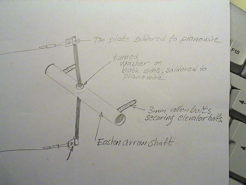

I really like the pull pull setups I have done on rudders and want to install one on the elevator of my next project. But I am not sure how to set it up. The servo will be mounted over the center of gravity. Whats the best way(s) to set this up for split elevator halves? Pics would be especially helpful!

Hi!
I use fishing wire (pull-pull) to control the elevators whenever I can on all my airplanes, used it lately on my Great Planes GEE BEE R2 instead of the wooden sticks that great Planes supplied in the kit.
But why use split elevator halves?? Just glue them together using a hollow aluminium arrow shaft (Easton).
Regards!
Jan K
Sweden
