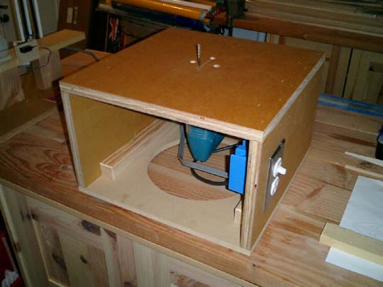

Here is a saw I built using a hand jigsaw. There was an earlier thread on this about six months ago. It can cut tight curves with a thin blade or track straighter curves like a bandsaw if one uses a broader blade. Not as smooth or quiet as the other two choices but not bad for a homemade unit.
Allan
