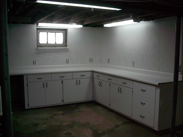

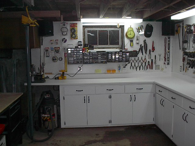

When I built my shop I used 3 sets of flourescent fixtures arrange so there wouldn't be any hard shadows. Then bought some type of bulbs that supposedly replicate sunlight (can't remember the name). They were about 4 times as expensive as regular flourescent bulbs but well worth it.
From outside the house at night, the light coming out of my basement windows looks really funny because it's that much different.
