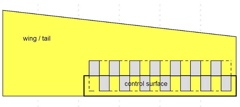

I've seen this design before. My hinges are a bit different though.
I make a series of hinges about 1" wide, applied side by side for the length of the control surface. That way, if one hinge did for some reason fail, all the other hinges would still be good. If the single hinge in the plans you posted lets go, then you'll lose your control surface.
I made up these sketches real quick. If they aren't clear, shoot me an email at [email protected] and I'll explain it a little better.
Mike
Mike

I like this method. Seems a bit more secure than the one in the article I posted. I was a little unclear at first, but I went back and looked at all your sketches there and I understand what you are doing. Looks like a little more work than the other method, but It appears that it will still seal the hinge joint, and make a more reliable hinge. Thanks for the tip.

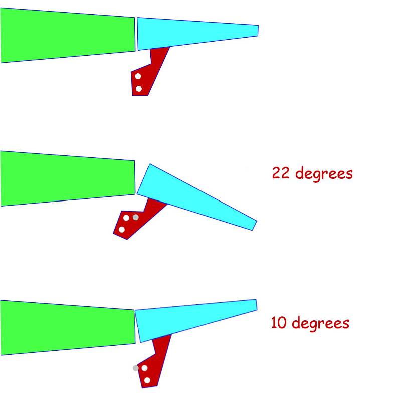

BTW, don't worry about having already shaped the surfaces' leading edges. The unshaped gaps actually aren't the best mechanical setup for hinging except on very thin surfaces. What happens is that the axis for your surface winds up with two different locations. Instead of having one "joint" it winds up with two. When your surface is moved up for example, the surface hinges at the top. When it is moved down, it hinges at the bottom. Now, where is your control horn positioned? It winds up seeing one pivot point when it goes one direction, and a different pivot point when going the other. What happens isn't a big deal, but that system shows the servo different leverages and sometimes different lever-arm lengths depending on how wide the surface joint is and where the control horn is placed. Not a big deal, but not a good deal either. And it will give you some differential deflections, again according to how wide the top of the surface is from the connection to the horn and how wide the bottom surface is from that same connection. More of a big deal depending again on how wide that "now flat" joint is from top to bottom.
Here is a quick sketch to illustrate the problem with square hinge joints.
When the pushrod pulls the horn a given amount, the surface deflects (in the sketch) 22 degrees down.
When that same pushrod pushes the horn the same amount, the surface rotates off a different point and in this case the surface only deflects 10 degrees.
The difference in deflection is a function of how far apart the top and bottom of the joint is and how far from the hinge line the pushrod connects from that hinge line. So if the surfaces aren't very thick, there won't be a big deal. But if you're hinging an aileron on a decent sized model, you will see significant differential.

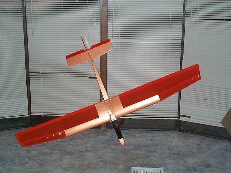

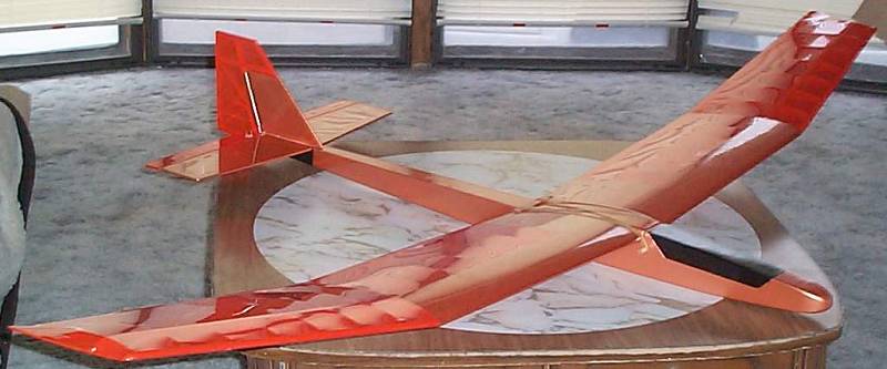

Here are a couple photos of the finished product. Have only a few minor details to take care of then when the weather gets a little better im going to take her out and toss her around to get her trimmed out.
