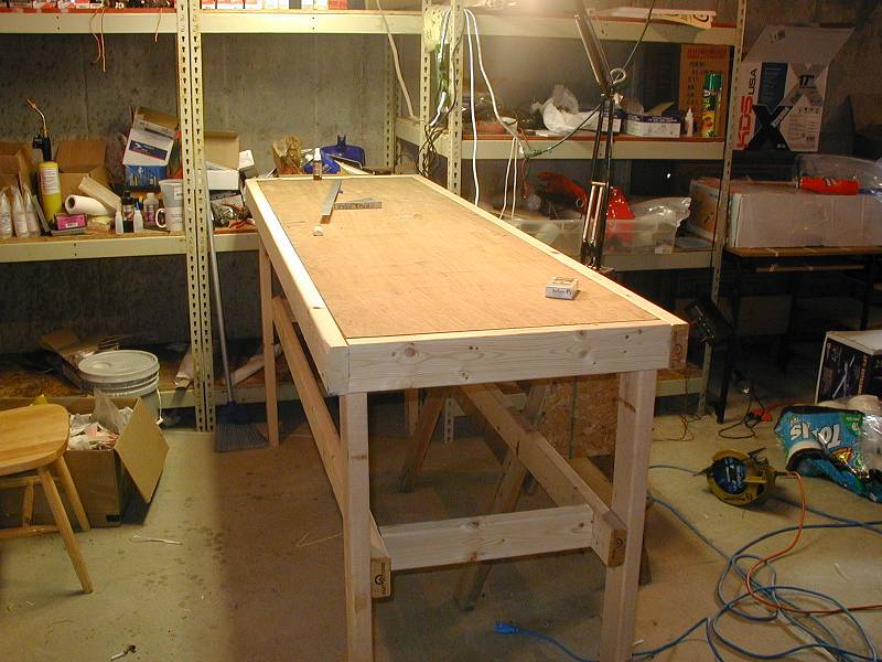

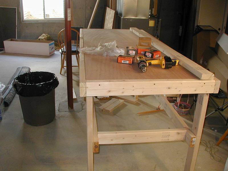

I built these for $50 apiece. Go down to the local big box hardware store and buy a hollow core door. Get the one WITHOUT the hole aready drilled for the door knob. They cost $20--$30 depending on how wide you want. I have a 24" door and 2 of the 32" doors.
Wrap the perimiter with 2x4s and add legs. It's not a bad idea to add a shelf about 24" off the floor. It's handy and helps keep the frame rigid.
Buy some screw-type adjustable feet for it and level it up.
I use 3" drywall screws for the frame. I only put 4 screws on each side and 2 screws on each end. Then slap a piece of 3/4" plywood on the shelf. I used 1.5" drywall screws for that.
When the door gets used up and full of holes and saw marks--just pull the screws from the perimiter and flip the door over. Brandy new building surface.
I haven't got the shelves in yet when these pics were taken, but you get the idea.
How high should my bench be?
Easy:
Stand up and drop your arms down to your sides. Now bend your elbows at a 90* angle and point your hands straight out. Thats the height that you want the table. Maybe a few inches lower--not to exceed 6" lower.
Mine are 42" off the floor.

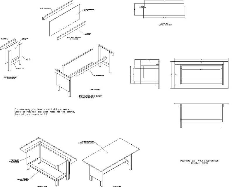

Hows this?

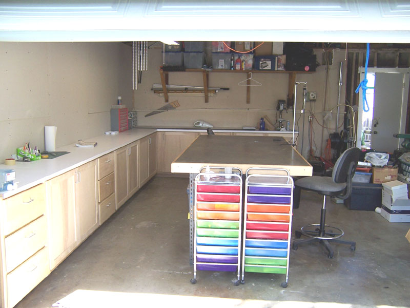

I built my new table after reading the information that Paul Johnson (Caffeenman) on his website www.airfieldmodels.com.
This uses magnets instead of pins for building. I made my build table from two Gorilla Racks I already had. The table top is made from two sheets of MDF with a 2 x 2 internal frame and a 4' x 8' sheet of 16 guage cold rolled steel top and all banded with 1 x 4 that I rounded over.
Scott

Scott,
Wher did you get the two roll stands with the stacks of trays, I like that idea.
Old 12-12-2005 | 01:07 PM
saramos's Avatar
Joined: Dec 2003
Posts: 3,057
From: Northridge, CA
Default RE: Workbench Plans?
I got them at Costco. They were about $15 each, as I recall. They are not the most sturdy units, but they are handy.
