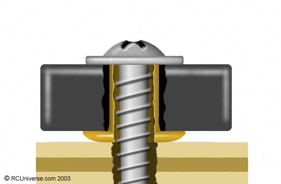

do the servo eyelets go on the tops of the servos against the screw heads or against the airframe on the bottom of the servo?

The flared portion goes against the airframe.

Default RE: servo eyelets
Like this
