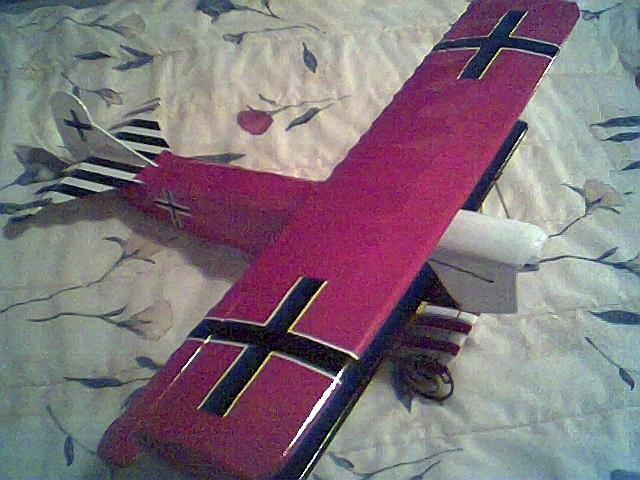

I am preparing the maiden voyage of the Fokker D -7 . the total weight is a concern. 25 oz. Area 365sq. in. wing loading is 10 oz. sq/ft What does this mean? and will this plane fly? Speed 400 2 33.1 gear 11/6 prop 11.1 lipo

Excellent looking Fokker, Is this the plane you were having trouble covering. With this wing loading, this baby should float right in, of course with all bipes watch the drag factor and keep a little power on. I have my eyes set on a Great Planes Gee-Bee which has a wing loading of 38 oz sq ft, now that would be considered a brick with wings.[]

The Fokker will probably fly ok. I see that you already increased the prop length by one inch to compensate for your elevation. I've flown similar setups here in Rochester (years ago) on 24-25oz planes with 40" wingspan.
The geared Speed 400 motors are considered "old school" today because of the heavier weight, lower motor efficiency, and brushes and gears that wear out.
What Lithium cells are you using? It is important to choose a pack that can deliver 10-15 amps continuously.
Good luck!
