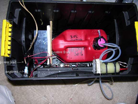

Well Im with everyone here and I found a very nice solution that so far has worked for almost 2 -3 seasons. Yeah you can buy the manual crank pumps. I still use the manual pump for back up but have yet to use it.
Anyway most of the electric pumps out there are the gear driven pumps so you can drain if needed. But if you look around in the local junk yard you have a prethera (sp) of pumps at your disposal. If you find any older volvo cars around the 86-89 range the windshield washer pump is a 12v gear driven pump that works very good for fueling the plane up. I picked up a pump there for like 2 bucks and has done very well. Dont know if the seals are nitro proof but, so far lasting almost 2 years it has yet to leak.
