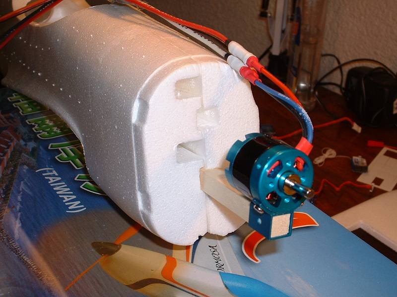

I'm a total newb to stik mounts and guess i'm just dence but i just don't see how to attach brush or brushless motors to them . Usually if i see something 1 time i get it but this 1 makes me feel dumb. can some 1 post close up pics and step by step how to's to put a motor on a stick and whats the diff between inrunner and outrunner mounting ty john

Many electric motors will come with the mount a stick type mount. All you do is drill a hole in the stick where the mount has openings (In the pic there isnt a hole drilled yet).

TY Gringo i think i see the curved piece around the front of the motor with 1 maybe 2 screws into it is that correct, and then the square piece around the stick and it's all 1 piece?

all one piece with 2 screws, this particular one is on a himax 2812. I have had problems with it bending on anything less than a perfect landing on belly landings. If you go with one of these motors I would recomend buy a few extra mounts as backups.

o thought it looked like it might be a little weak towards the back end if all the attachments were at the front ty again gringo i think i'm finnaly getting to see the foest for the trees

this motor is an outrunner so the black part of the motor back is what rotates, the only part that doesnt rotate is that blues frame where the mount is attached to
However you can reverse the motor and mount it from the back, but then you cant use the stick mount you go with a firewall mount
