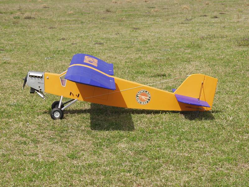

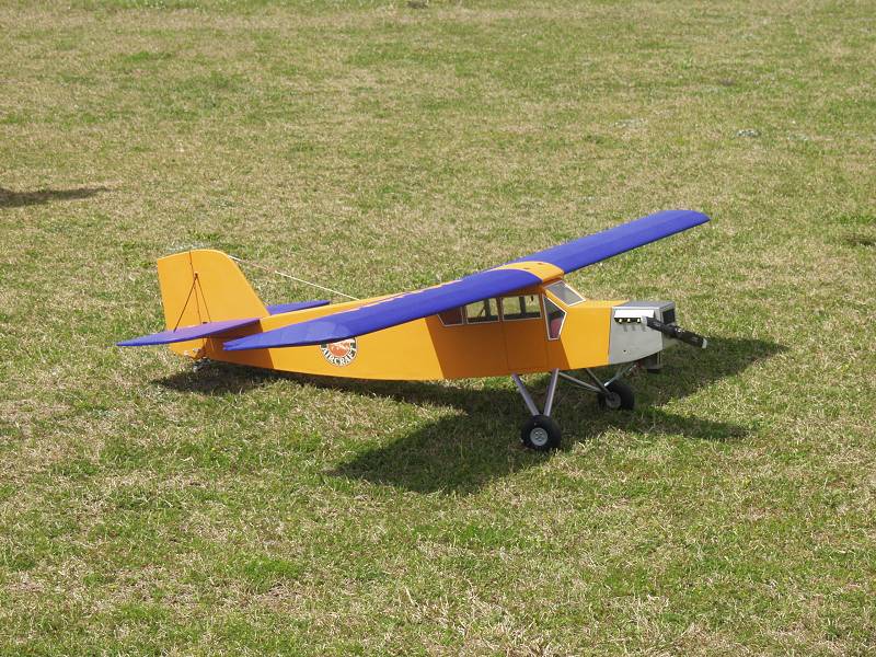

Here is my Solartex covered Robinhood 80
