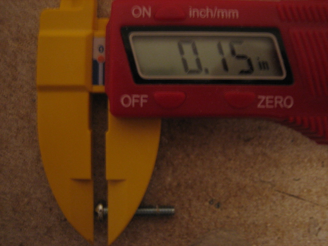

Are these mount screws suitable for this purpose? Do i just use a bit of Locktite to ensure they do not come out of the blind nuts?
BTW: This is a OS 46AX on the mounts from the Kit (Engine just CA'd on at this point).

Photo 5&6: Head of mount bolts are approx 0.15 (including a small gap)

In regard to the engine secring bolts, just use the nylon insert lock nuts without locktite. You can also use metal self tapper screws. They won't vibrate loose in a hurry.

Realised you were referring to the mount to firewall bolts. Use ones that will sit fully in the threaded section of the blind nut or protruding a couple of millimetres. Just use some spring washers on top of a normal washer. You won't have any problems with these loosening up. Just check by holding engine and twist slightly. If loose, tighten.

The bolts supplied are not long enough
I'll go get some more steel bolts with a hex head and spring washers for the mounts. Thanks.
