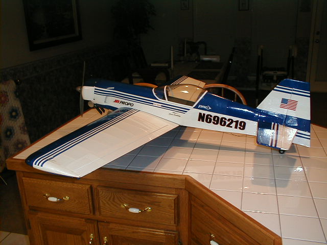

Hi Guys. I have flown the plane about 7 times now. I have only had one tough time with it and I recovered luckily.
I let it get too slow coming in on a too high landing. The plane does indeed fly great. It is real smooth. The only problem I have is seeing the dark blue bottom in the blue sky, But that is me. I will put a few white stripes on the bottom and take care of that problem.
Thank you all for your replys.
