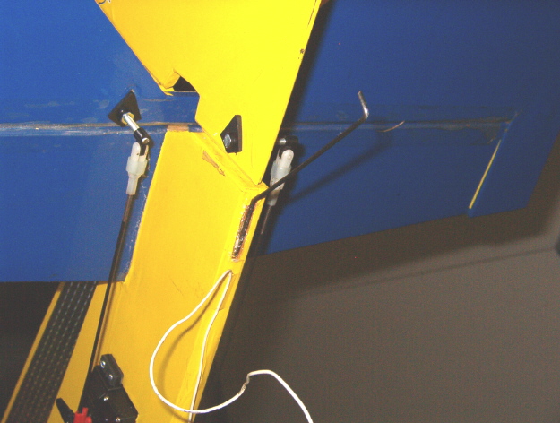

My suggestion would be for a simple tail skid in front of the stab. I have 1/16" music wire as a skid on my 46 and 70 size Katana's without any loss of ground steering. With a partial candy cane bend at the end of the wire, it doesn't create any noticeable drag. Is there a way to add a hard wood wedge block in front of the stab? I don't know how to add a sketch on here, but I could take a photo of the style on my planes if that would help.

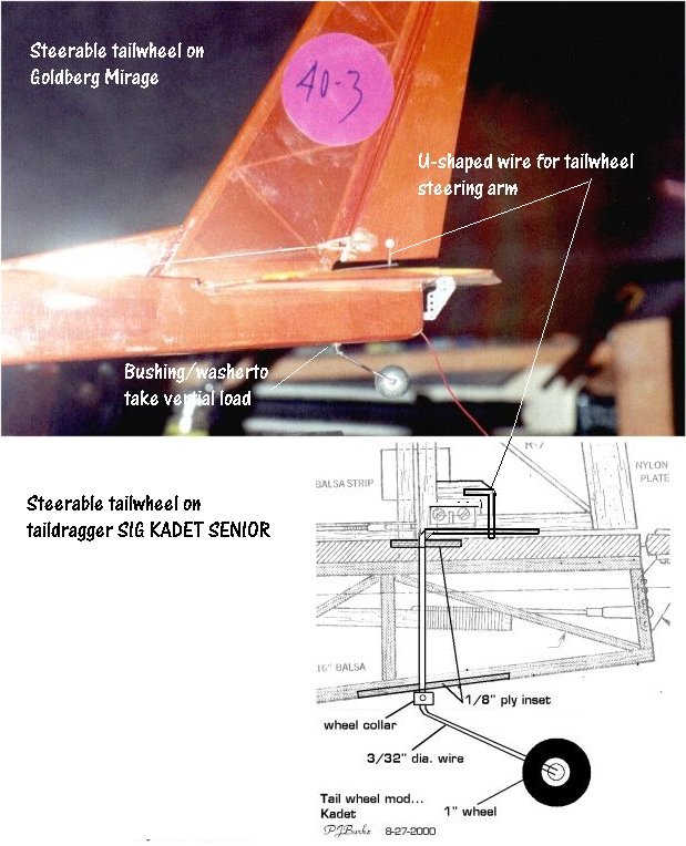

I've moded already built planes to tailwheels..
A Goldberg tail wheel mount would let you slip the control wire into a loop on the rudder.

Mounting in front of the stab, it will still allow you to remove the stab.
