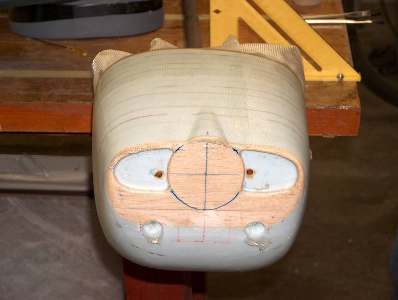

Hi. I've search for some threads on how to build a cowl, but haven't found a good step by step technique. Are there any sites, mags, etc. that show step by step intructions?

You can make a fiberglass cowl using the "Lost Foam" method. Here is few photos of a recent one I made. Laminate blue foam sheets to get the size you need, sand to shape and glass the outside with fiberglass cloth and epoxy.

Old 03-29-2007 | 07:10 PM
Posts: 1,912
Received 57 Likes on 55 Posts
From: Springdale, PA
Default RE: Building a balsa cowl
Once the epoxy cures, melt the foam out with acetone or gasoline, I found that gasoline works as well as the acetone on blue foam.

Old 03-29-2007 | 07:13 PM
Posts: 1,912
I used balsa where finer detail is necessary

That cowl looks great. When you say blue foam do you mean the stuff that home depot sell's that is about a half inch thick and real smooth? Also what weight glass do you normally use. I need to make a cowl and a set of wheel pants and this will be my first attempt at it.
