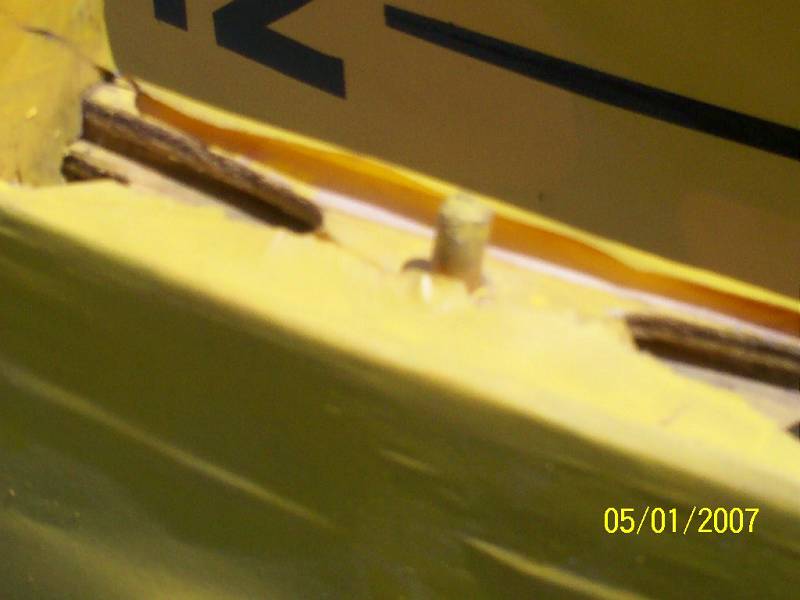

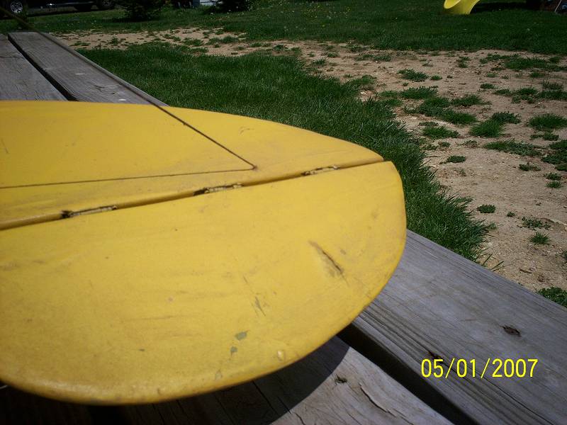

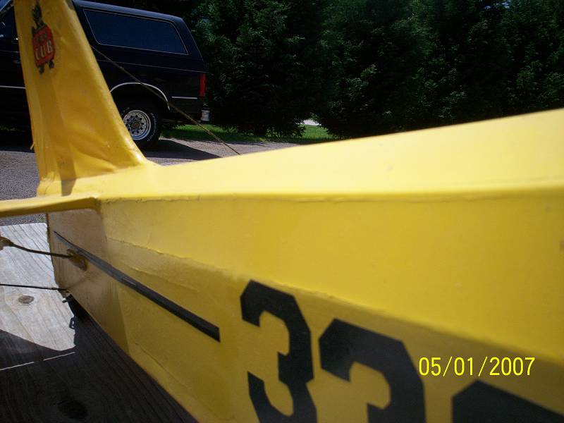

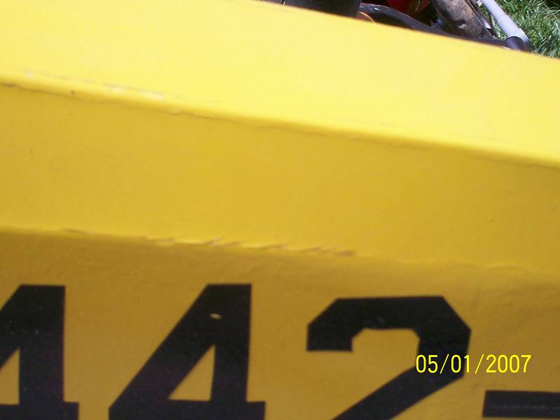

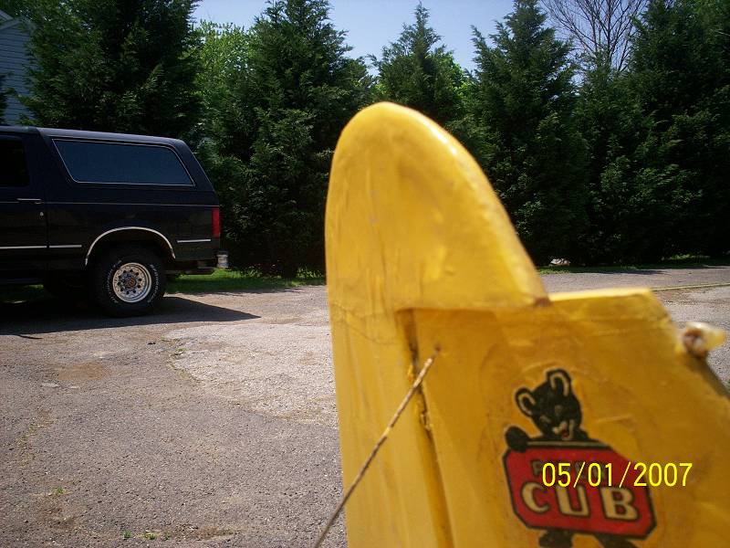

Hello all,
I have an old Carl Goldberg Piper Cub. It is about 13-17 years old. Give or take a few years. The plane has a few spots that look like they should be fixed. I have never flown it. I would like to get it ready for some air time, as my skills will be ready for it soon.
The covering looks like a fabric. I looked around and found that Fabrikote was used a long time ago, and is no longer made. I came across Coverite 21st century. Any thoughts??? As a new pilot I have never seen this kind of covering before. It does not look like any of the Mono on my other planes. The covering looks real brittle and hard. It does seem to have some flex in it though.
So what do you think I should do? Can this old covering be fixed/patched or do you think a recovering is in order?
-Andrew

I would recover it. Just slowly work the old covering off. Then you can repair any damaged areas and recover. Coverite or monokote would be alright. It's a fun aircraft to fly.

most of what you have shown will disapear if you run an iron over the covering to reshrink it.as you are still learning I would just reshrink the covering,patch any holes and fly it for the summer,then if you want recover it next winter.

Take the time and recover it. Use the Solartex, it's a little more user friendly than the 21st Century product. Since it will be opened up, inspect all the glue joints and touch up as needed. After all is said and done you'll get to go out and really learn to fly. The Cub absolutely requires using the left thumb if you ever want to turn. They're a blast to fly, and even more fun to watch someone fly that never uses a rudder. You'll have to T/O and land for them though

Repairing is possible as most look like problems with the paint. You need to find out what type of paint it is. Buy a bottle of yellow butyrate dope, some yellow Coverrite paint, and a can of Lusterkote clean off the plane with some denatured alcohol, and paint a test patch's on the bottom. If both Lusterkote and the dope work with no problems then the plane is likely painted with butyrate dope, if only the Lustercote then it was painted with Lustercote or automotive acrylic lacquer, if the Coverrite paint is the only one that works then the plane was covered in Coverrite or painted with a polyester paint. Once you know what it is you can buy material and paint to patch it.
