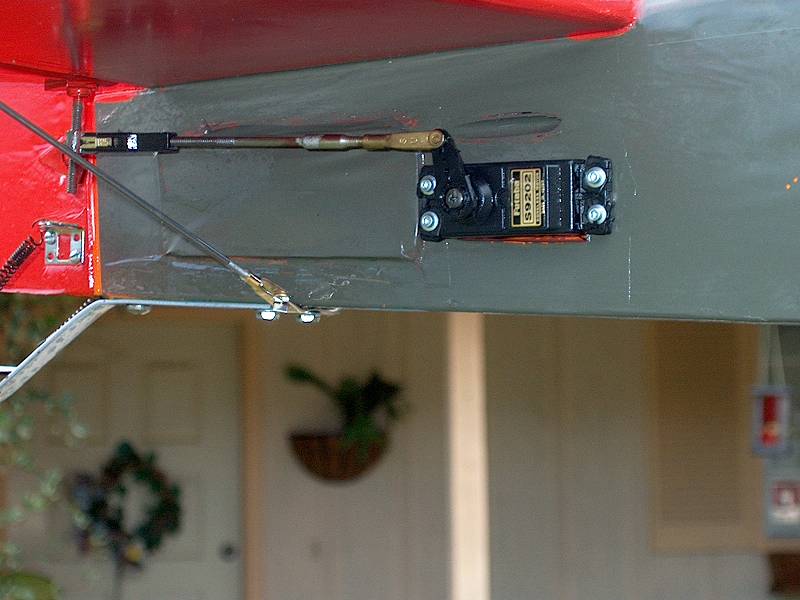

I STRONGLY agree with bbbair and jaka...you can put a servo extension on the battery pack to move it back as far as needed to balance the plane, or move the elevator and/or rudder servo's to the tail to make it balance. This also gets rid of the elevator and/or rudder pushrods which further lightens the plane...a win-win way to solve the problem.

Adding weight just cuts performance. Here's a photo of a 4*60 I had where I moved both the rudder and elevator servo to the rear for balance.
