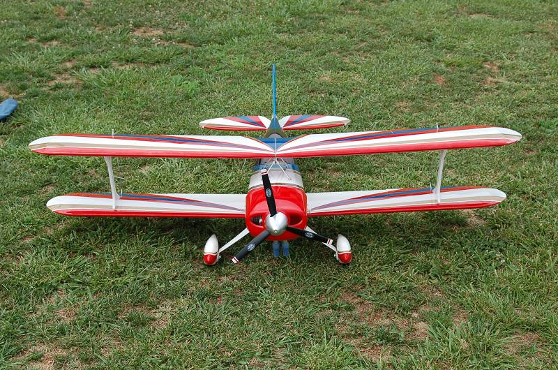

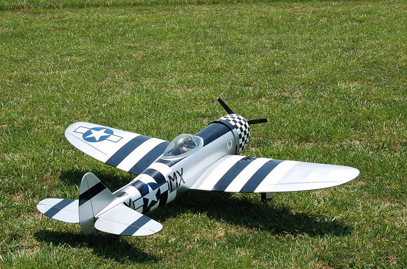

These two airplanes fly great on the props they are pictured with. They also happen to fly great on 2bladers. They also fly not so great on the 2bladers they don't like and the 3bladers they don't like. But there is almost nothing to choose from between the best 2 and the best 3. As for "efficiency"........ the engines don't seem to notice any difference and perform equally well with either, the spectators can't tell which is on the airplanes, and the airplanes don't show any difference in flight performance.

I included pictures of two popular airplanes that fly excellently with 3bladers up front. If there is a difference in their performance from the 2bladers that've been on those same airplanes, it beats me what it is. As for a difference in efficiency, whatever that is, I've not even noticed a difference in fuel usage. But haven't actually done anything to test that as that aspect of "efficiency" is totally irrelevant to my choice of props.
It actually appears that the only real problem with choosing a 3blade or 4blade prop for our engine/airplanes is the lack of those props in different sizes and pitches.

I just spent an hour or so searching the internet. Again. I looked really hard a month ago when I was trying 3bladers on my P47 and wanted to try 4blades. And was wanting the same for my 61engines. The problem we have is basically that there are only a very, very few available. I had to settle for a 3blade on the P47 because there wasn't even one 4blade in an appropriate size.
There does happen to be one manufacturer that offers a possible solution for larger engines and modelers with deep pockets. They offer a prop system that has 2, 3, and 4 blade hubs. Their hubs take the same blades (about $8 a blade depending on size) but take different numbers of them. The hub adjusts the blades to whatever pitch you want. You choose the number of blades, and buy the diameter you want. Then test and adjust the pitch to suit your application.
Is it a realistic solution? Not for me right now.
I've tested and found that my P47 works great with the 3blader, as good as with the best 2blader. And it looks better scale wise. "Better" is about all I can do right now. But 2 blades really look wrong. Three blades doesn't look bad. And they fly great.
