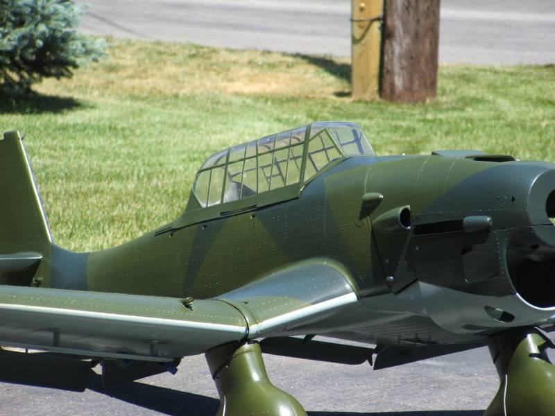

Default RE: glassing
I used MinWax sanding sealer to seal the balsa before I glassed my Stuka with MinWax PollyCryllic. There were no compatibility problems encountered.
Both were purchased at Home Depot.
