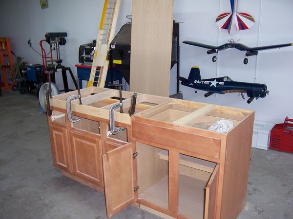

30x80 slab for $1.00 at menards. If you can find a damage higher end door, they are stronger than the cheap ones.

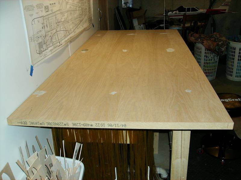

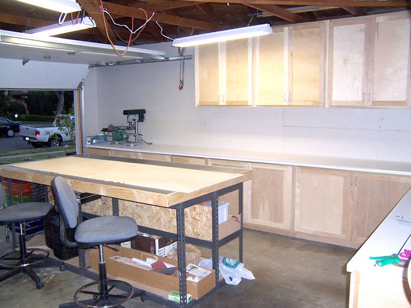

I built my 4' x 8' table top from MDF and pine. I created an inner structure of 1X2 frame with 16" spacing. The top and bottom sheets are 3/4" MDF (Medium Density Fiberboard) The whole top was banded with 1/6 pine. I set the pine banding 1/16" above the MDF. I then added a 4x8 sheet of 16 guage cold rolled steel and use magnets instead of pushpins. For my base, I used two sets of Gorilla brand metal shelving units unstacked.
Scott

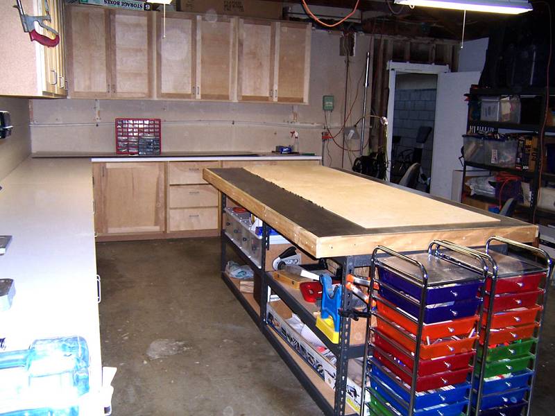

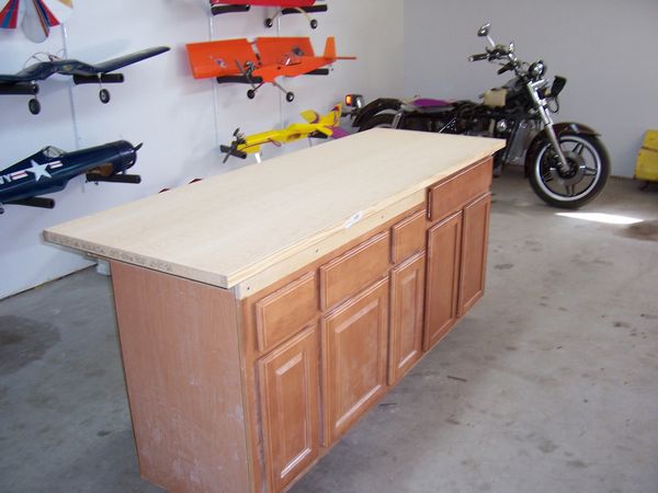

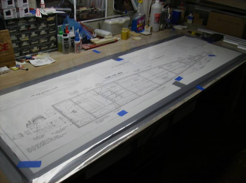

I don't know what went wrong but my computer mnessed up my post and even put a wrong picture in it. I have two work tables. My primary table for building my Giant scale Warbirds is MDF with Elmers foam board duct taped down to it to hold the T-Pins. It is 3.5'x8'. My secondary workbench for working on smaller planes and for building smaller parts of my Warbirds is a Oak hollow core door with the foam boards. The foam boards I get at Walmart. They are 20"x30" and cost less than $3.00. Both sides have a thin vinyl coating that doesn't adhere to CA very easy. This table is 32"x6'8" and is in a seperate room of my workshop. Now I will try to send those pictures again. Oh, the frames for both table are made out of 2x4 studs and are very sturdy. I store more kits under them. The one picture above is my 1/8 scale F4U-1D Corsair on my cutting table. The smaller table in the second picture has my 1/4 scale Don Smith F4U-1D Corsair plans on it to give you a size comparison if you ever want to build Giant scale you will need at least an eight foot table.

I think I should give up after seeing Lt. Doc Millers butt in one of my pictures and still no primary table. But I never give up. There's my primary table. Sorry for all the dumb pic's and so many posts for just 3 pictures.

I managed to get a laminated schoolroom door from a highschool remodel job. It is at least: 2" thick X 36" wide X 7' long. The only problem is it is also around 175 lbs!! I used 7/8" unistrut reinforced 4X4 posts as the legs for stability. The legs also have independant adjustment on the bottom via 1/2" carriage bolts and countersunk nuts for the threads. Strongest darn thing I ever built!!!
I covered the top with a roll of 1/2" medium density foam - similar to the white stuff great planes sells for battery and tank vibration isolation except a little firmer. Don't know how I'm ever going to get it out of the basement when I move...[sm=72_72.gif]
First worktop was a hollow-core interior door. They are ok but do not try to cut it down unless you have a table saw and can cut a new header member for the core!!
