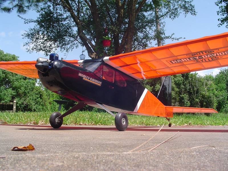

I too prefer applying Ultracoat over Monokote in general but have covered a couple of planes with transparent Monokote with good results. I haven't tried any of Ultracote's transparent colors. Here's my Kadet Sr. that uses transparent orange Monokote.
