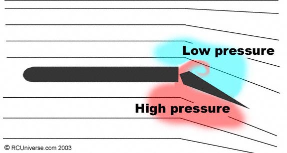

Default hing gap sealing
I saw a few threads about people talking about this. How do you do it and why?
Old 04-08-2003 | 03:27 PM
MinnFlyer's Avatar
Posts: 28,519
Received 9 Likes on 9 Posts
From: Willmar, MN
There are several reasons why. The two most popular are that it can lessen your chances of creating flutter which can damage the plane, but mostly to stop air from flowing from one side of the control surface to the other through the gap. This greatly increases the effectiveness of the control surface.

how does a feller go about doing this? and with what materials?

You can use anything from a strip of covering to cellophane tape. It is usually placed on the underside to hide it. fold it into a "V" shape, deflect the control as far as it will go (disconnect push rods first) and adhear it to the gap area.
