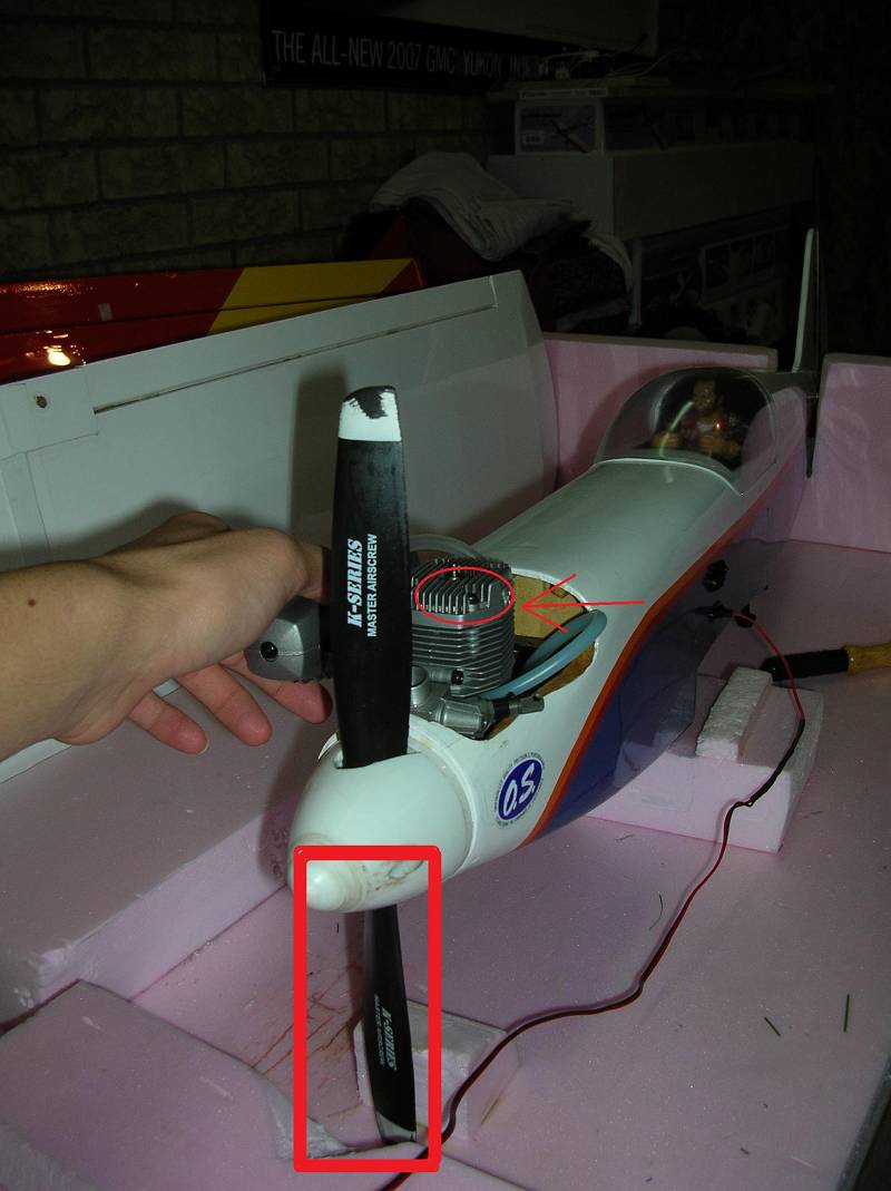

The thory is that one should get a prop balancer and find the heavy blade and mark it, now when you mount your prop you bring the piston to TDC and the prop goes on so that it is parllel to the piston travel ... (heavy side down)
Im just going to try and scetch somthing up...
So the idea is that the heazy blade balance out the piston and there always opposit to each other if it works well thats an opinion becasue some say that when the prop is horozentil it makes it worse and it spends half it time horozonetle.. (i just balance my props...)
So with piston at TDC the heavy blade is the one with the red rectagle around it, I dont use this but i do knwo about the theory...
