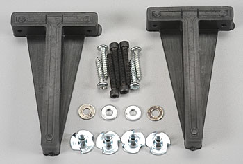

I have a two piece engine mount. After drilling the engine mounting holes there is no right offset. Putting washers under the left mount does not seem to change the offset. I was considering sanding/filing an offset in the back of the mounts (where they attach to the firewall). Re-drilling is not an option. Any other ideas?

Putting a washer between the left side of the mount and the firewall will definitely give you some angle. If it's not enough, add more washers

Putting washers under a two piece mount does not work the same as under a one piece mount. All that happpens is that the mounting holes become misaligned. The mount that I have has two beams that are not connected as shown in the picture that you put up.

Jerry, it will still work, just mount the engine first.

if washers won't give it change, you can make a shim out of plywood, but it's a bit more work as you have to sand the angle into the ply which should be the same dimensions as the back of the mount overall.................what kind of mount is it?
Great Planes 2 piece mount will allow the use of washers, but i have seen a couple of 2 piecers that would not shim out with washers.............

The mount came with a Lanier ARF. I looked and found a mount that is close to what I have and have put a pic up.

OK i see that it's not one of those that tries to flatten out when shimmed.................like Mike says, use more washers. you'll surely get some angle change, or better yet as you already said, sand down the side you want to give the angle.......

But sanding it down will make it weak.
You could also just glue a strip of 1/8" ply to the back of one, and then sand the plywood to the thickness AND angle

Try Tower Hobbies and search-Ernst,thrust plates.
Worked for me.
Good luck,fredsedno

That seems to be just the ticket. Thanks for the post.
