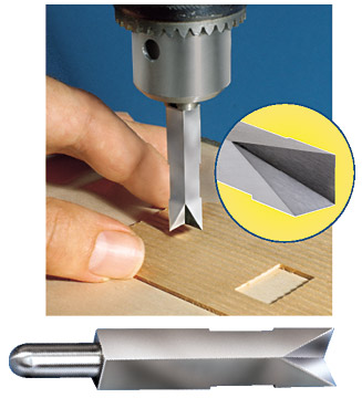

These things were similar to the ones pictured below. They were sold in nominal sizes to match common spar sizes. I had a 1/4" for the longest time that made spar notches beautifully in ribs and formers. MicroMark sells some that are available in 3/16" and 5/16" that are similar in idea, but frightfully expensive.

[sm=lol.gif] OK, the second one is kind of funny. If you put a square bit in a collet and turn on the drill, the motion of the bit becomes "round". How does it create a "square" corner?
Honestly, I think the picture is just not accurately showing how the thing works. I''ve seen something similar and it was a drill bit inside a square sleeve that basically acted as a chisel to square the corners.

I believe the second picture shows the tool being used in a drill press, where it would be used without turning the drill on.
Dan
Of course... Now I feel foolish.
