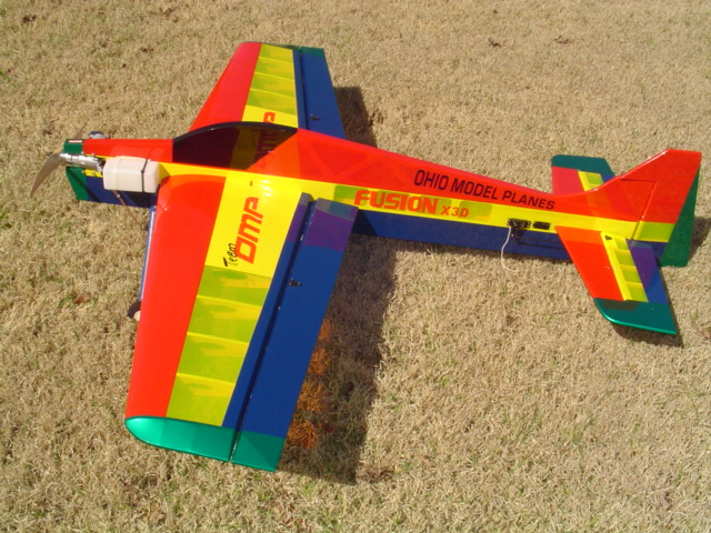

Old 04-20-2008 | 08:49 PM
daveopam's Avatar
Posts: 7,810
Received 43 Likes on 38 Posts
From: ELK CITY, OK
Default RE: does monokote get too old to use?
The green on this is 17 years old. The blue is 10+. Both were open and have been in my shop the whole time. It seems to take a little more heat to work with it other than that it is fine.
David
