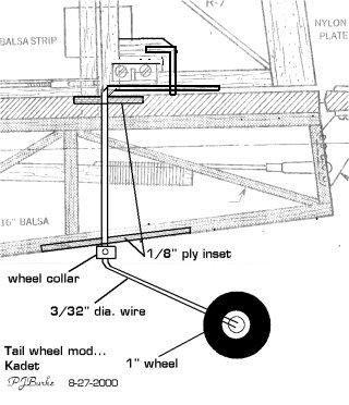

Ive had hanging around a SIG KADET LT 40 trainer. Id like to make it a tail dragger. I just sit and stare at it and cant seem to come up with a solution,,,Has anyone done this feat. If so ,would you explain how you did it ,,,maybe some pics. I just tired of bending nose gear all the time. Even under normal light landings she eventually bends the gear.

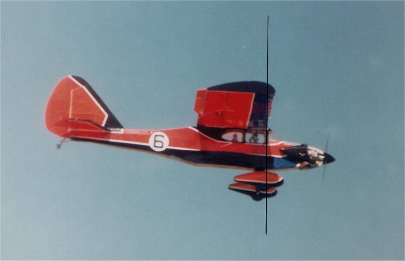

While i have not convertred a Kadet LT-40, as a general rule/starting point, for placement of mains, they should just be visible protruding from leading edge when looking straight down. There are a number of steerable tailwheel brackets available. Since the rudder does not go below the elevator.. that's a bit more work to make it steerable. An easy solution would be to run an add'l pushrod back to the tailwheel bracket off the rudder servo.

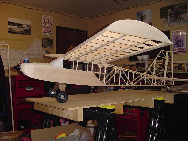

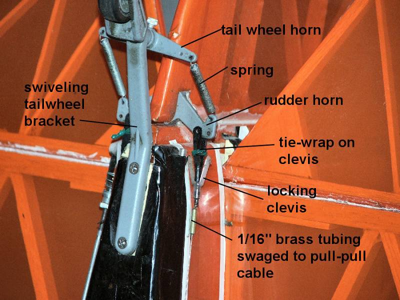

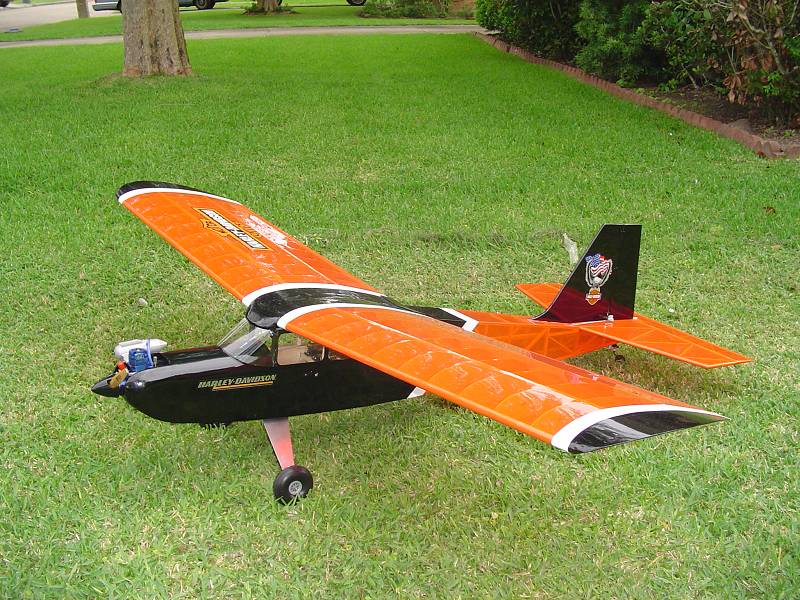

While I have no experience with the LT-40, I did convert my Kadet Senior to a t.d. I added a piece of hardwood in the bottom of the fuse frame and screwed a Great Planes scale tailwheel into it. For control, I used a 2-56 pull-pull cable setup attached to the rudder servo. As mentioned before, I mounted the mains with the axles just below the wing leading edge. Had to epoxy some plywood in the fuse floor above the gear to beef things up a bit. Overall, a simple change to make and I'm very happy I did it. It is easy to handle with no groundlooping or noseover tendencies but you need to bring'er in slow and shoot for a full-stall landing. I think it makes the plane look much more "scale-like" and less like a typical trainer. Recently, I added a FlyCamOne2 video cam under the left wing and am now enjoying this plane in new ways. Good luck with your mods.

I converted my LT40 to a tail dragger some time ago and was most pleased with the results. I solved the physical limitations of the rudder mounting by adding a control rod.
I moved the landing gear so that the axle was aligned with the leading edge then added a new push rod to the rudder servo. This meant cutting into the tail section with a piece of hardwood for tail wheel mounting as well as removing a piece of the fuselage so that I could gain access to and route the new control rod. This damage was easily repaired - especially in a banged up trainer (:-). The interesting thing about the mod is that there was no need for rebalancing. I guess moving the main gear forward countered the loss of the nose wheel.

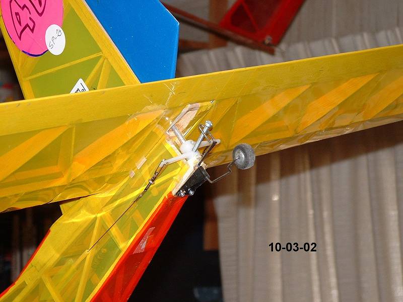

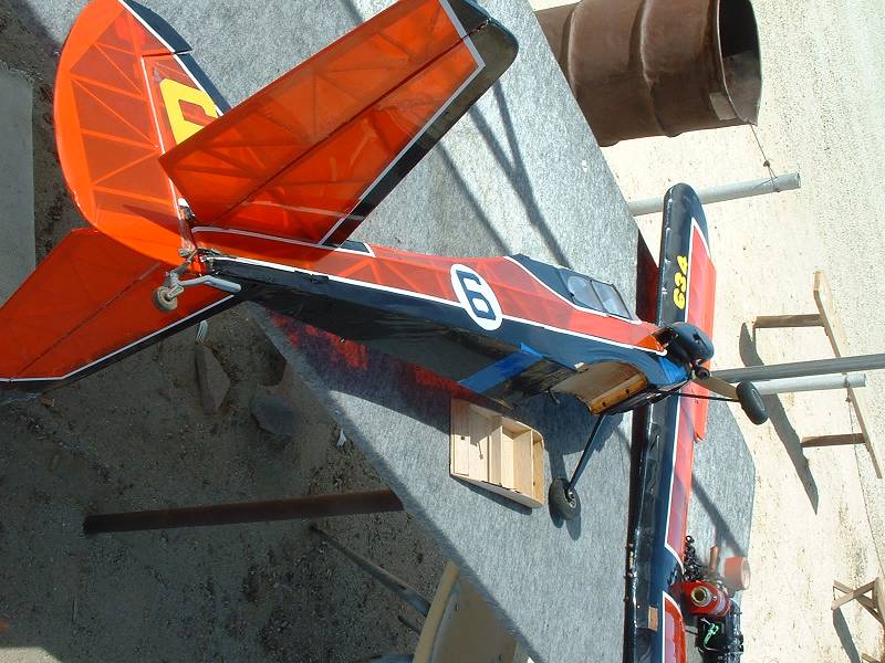

Couple ways to do it...

I appreciate the comeback.. What did you use for the main gear? Id like to get rid of the wire ones. Also what engine are you running,, Ive got a OS 46 mounted, would mounting a dural main gear and adding the tailwheel assy add to the weight,,therefore needing mor power? Ive got a new 55AX I can use.

I used a dural main gear on my Senior which is larger than your LT40. I fly it with an OS 40LA and it's just fine. Not a hotrod but a good flyer regardless.

Sorry Tazz I got caught up in the Hughes.net service outage and forgot about the forums. I went with the (nylon?) Du-Bro main gear, not sure on the tail wheel but most likely Sullivan. My LT40 is powered by an OS40 2 stroke which furnishes more than enough power for what I call "normal" flying.
I didn't weigh the plane but I wouls expect it to weigh the same or slightly less. I don't feel it's something you need to be concerned about. The plane, compred to my Senior Telemaster, is certainly not a floater but is not a difficlt plane to handle on takeoffs and landings. We fly off a dry lake bed in Nevada so it's not all that smooth however there is no excess of weaving on takeoff,,, it handles the conversion quite well.
